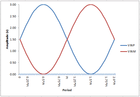

Dear Sir:
Now, I'm using 28377S as my master CPU.I think the 16 - bit ADC is one of its important resources and highlights. But when I was using this ADC, I met a problem,especially when the signal was AC voltages.
According to the datasheet, if you want to use the 16 bit ADC, it must be based on a differential mode. Because the voltage of the input signal of ADC cannot be negative, it will cause trouble.
Now let me summarize my application as following:
A The input signals are AC voltages.
B I want to use 16-bit ADC,not 12-bit.
C My PCB is limited and there is not enough hardware transfer points to pass the analog signals.
D Suppose VREFHI=3V, VREFLO=0V,and the 1.5V bias has been done in the prefabricated analog circuit.
I read the "28377s manual" repeatedly, especially tables 9-3 and 9-5. After a lot of thinking, my final conclusion is that unless the full difference mode is used, the 16 bit ADC can only be used by 15 bits.At the same time, all the ADCIN_N signals are connected to the 1.5V.
I am not sure whether my analysis is correct or not, please correct it.
