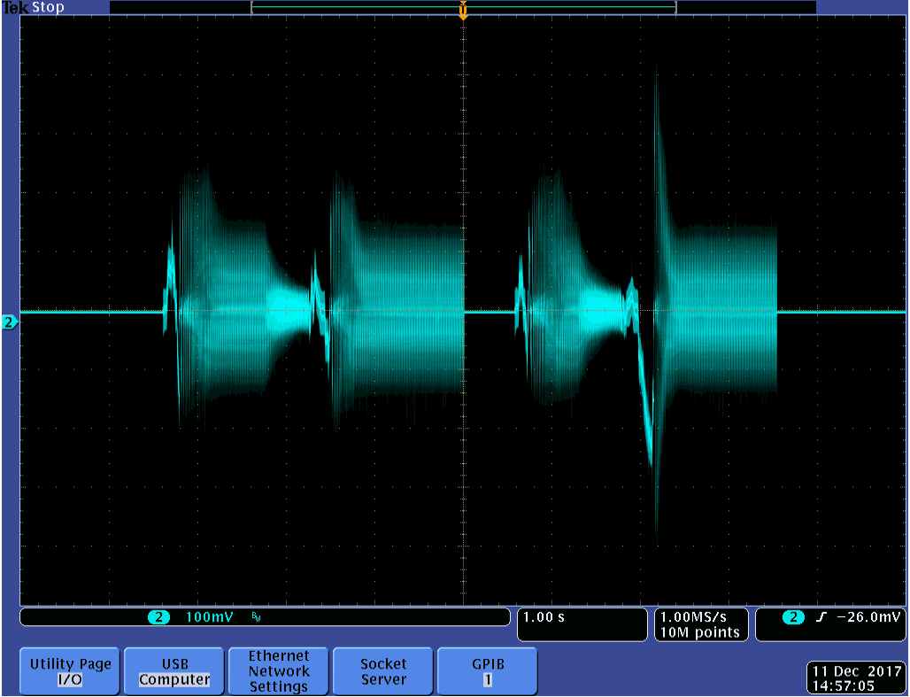

Hi guys,
My Motor is an 230 BLDC Motor. When I set an Motor Speed the Motor has sometimes Current Overshoots at Startup.
Then comes the protection circuit triggers from the electronics
I use the PROJ_LAB05e with this Motor Parameters.

With Lab5c i learned the Inertia und Friction Values.
Is this correct that Friction can be negativ ?
Can you give my an advice why i become sometimes overshoots at startup.
Alex
  • You need to use the lab02b/lab02c to identify the motor parameters first, and then use lab05c to identify the inertia and friction of motor without loading. Why the USER_MOTOR_IND_EST_CURRENT is NULL since the motor is a PM?
    Tune the USER_SYSTEM_BANDWIDTH_SCALE to spin the motor for startup and running after had correct motor parameters.
