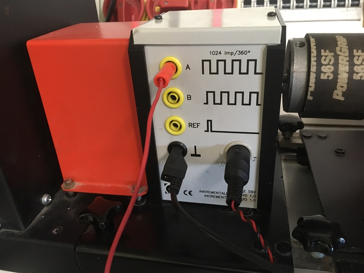

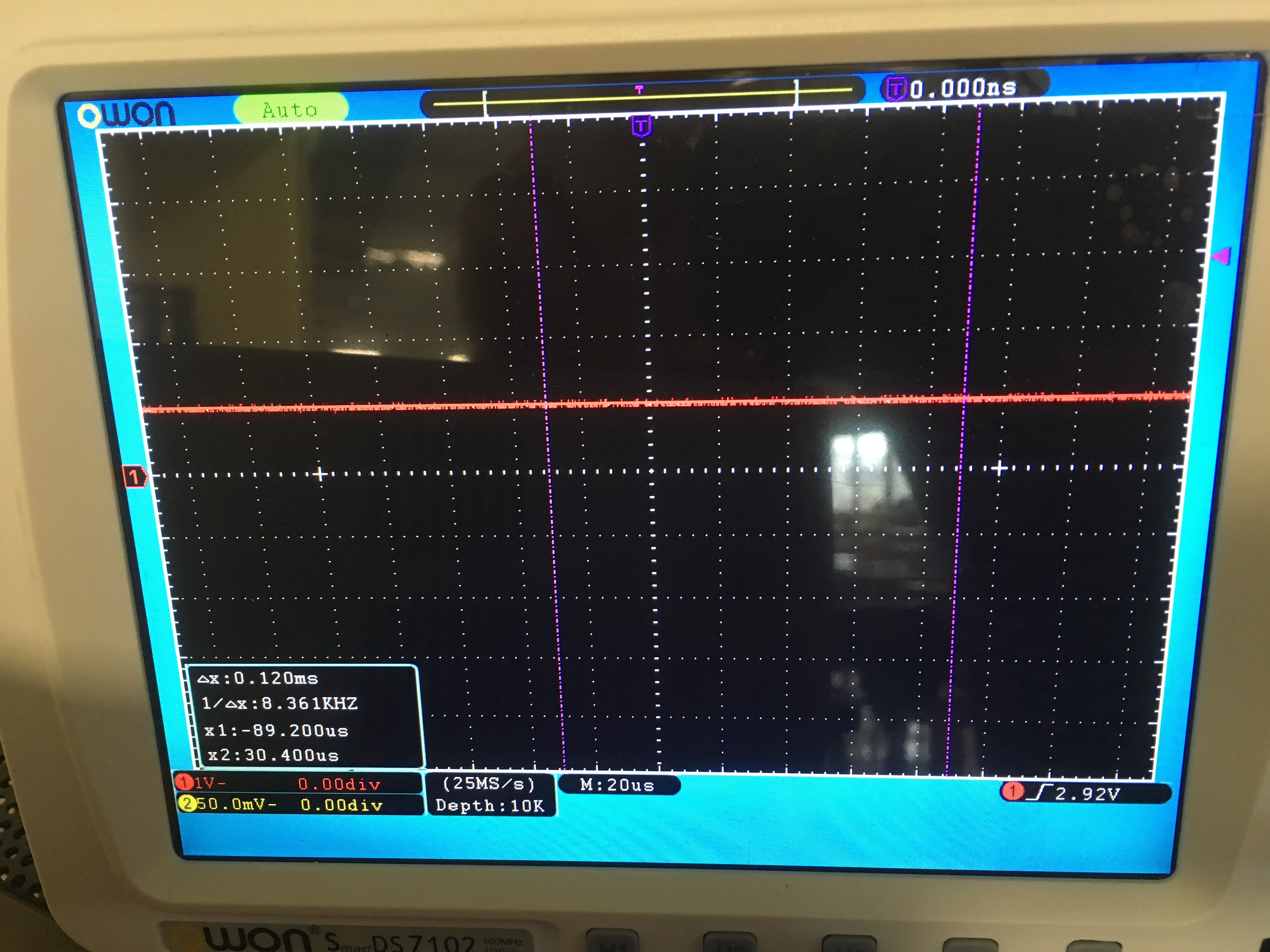

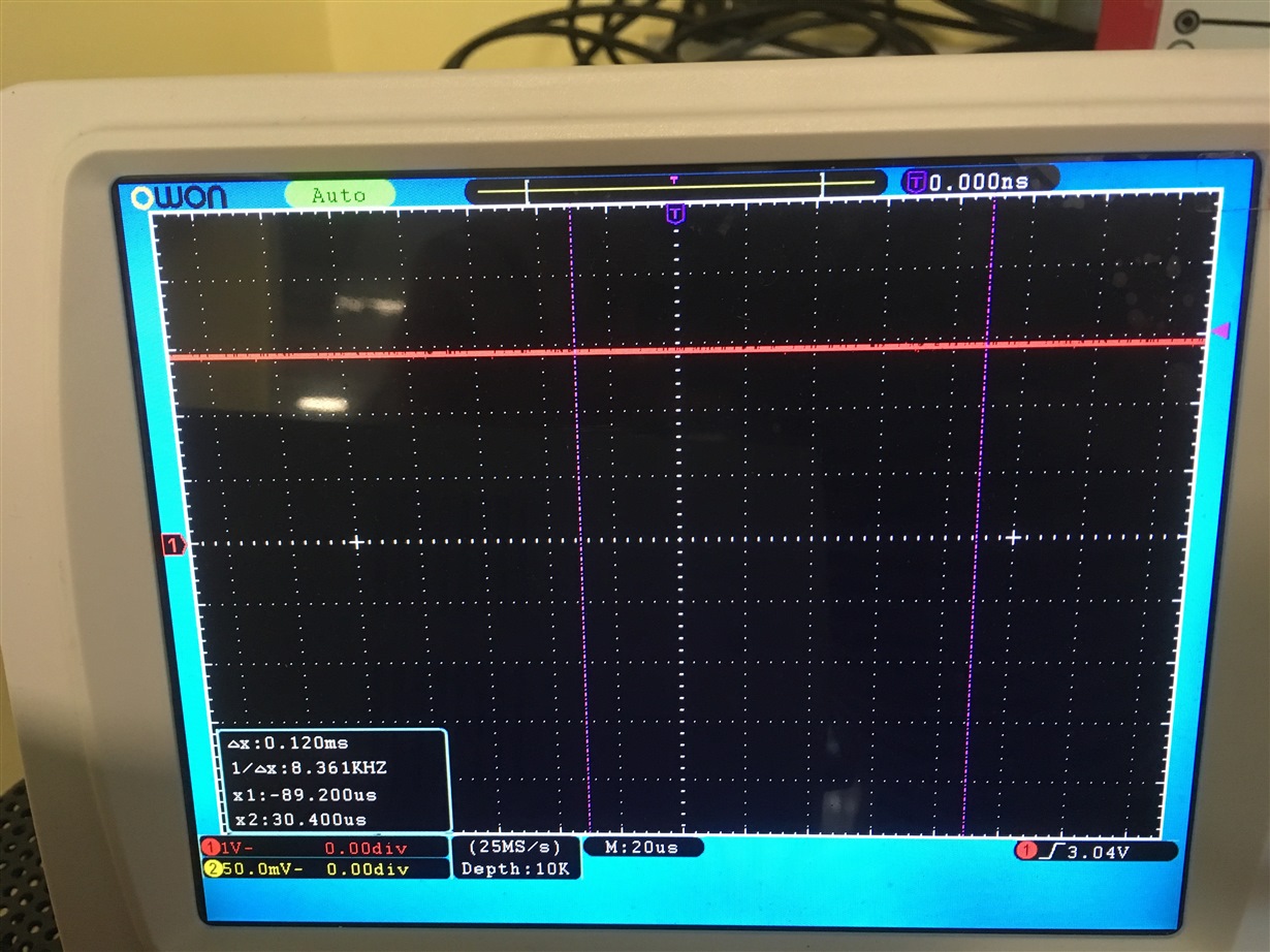

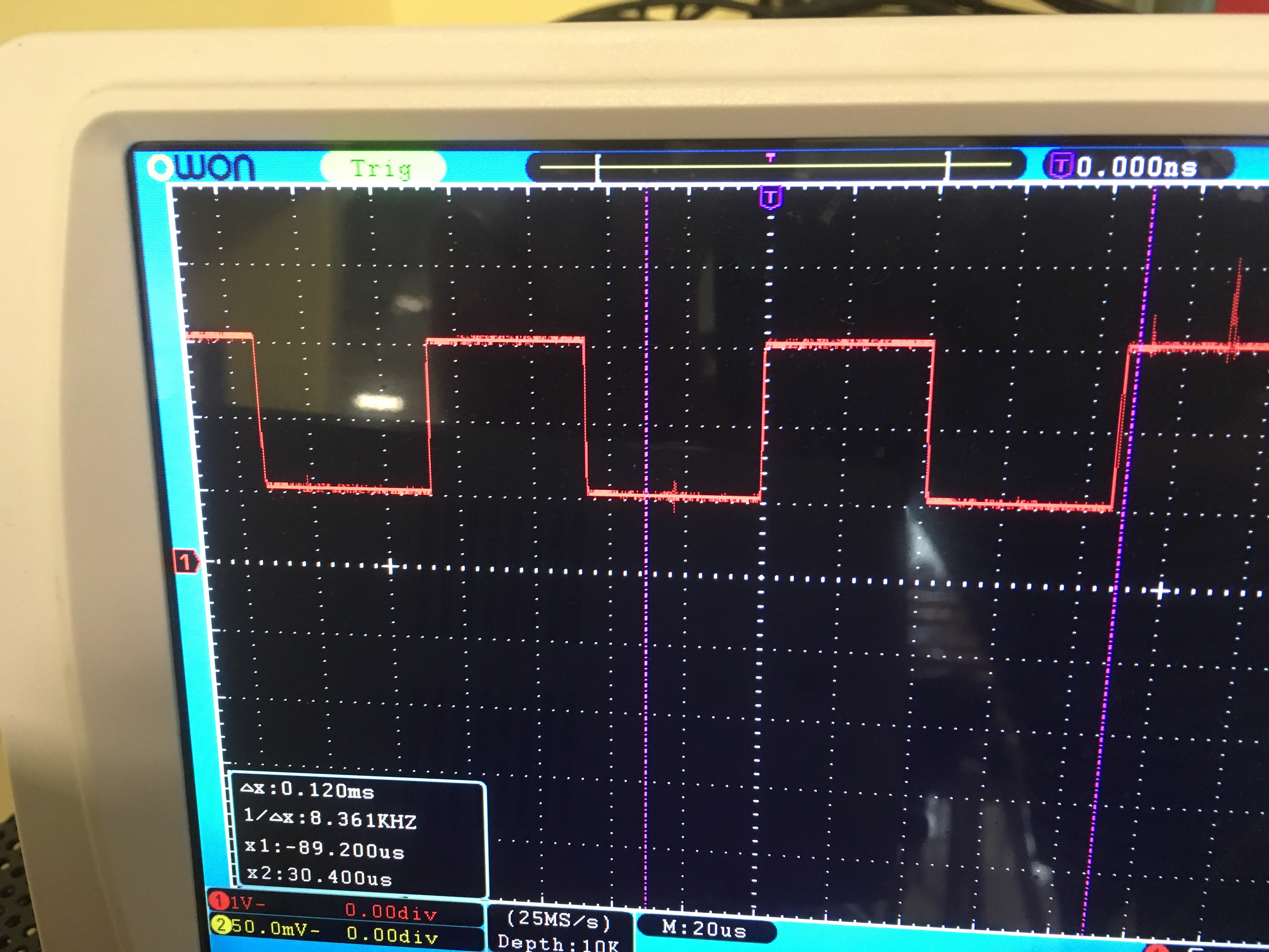

I try to measure the speed of a brushed dc motor using an incremental encoder. I use eCAP module and I have implemented both time difference example and absolute time with Simulink. When I connect the eCAP pin [GPIO5] with GPIOO [PWM1]  then I am able to measure the period of the signal. Unfortunately, when I use the signal from the encoder the system get stuck and Simulink loses control. The signal from the encoder as I capture it with the oscilloscope is the following:
I am wondering why the signal is starting from 1V and not from zero? Is that a problem? When Simulink loses control the DSP keeps working and I am able to change the motor speed but there are times where the speed it isn' t stable. The higher the frequency the speed gets more stable.
The pull-up resistor is enabled.

    Did you have any pull up enabled or any other circuitry connected to the pin?
    That might be the reason for non-zero voltage at the beginning.

  • Yes the pull up resistor is enabled [GpioCtrlRegs.GPAPUD.bit.GPIO5 = 0;   /* Enable pull-up on GPIO5 (CAP1)*/].
    I use a voltage divider in order to low the incoming voltage from 5V to 3V [input pulse A from encoder].
    Is this "normal" the pulse to have one voltage offset not only in the beginning but later as well? Maybe this is why Simulink get stuck?

  • Could you check the encoder output signal voltage - not connecting to the device pin?
    You can disable the pull up and observe the results.
    Also, observe if there is any noise on the encoder inputs, even that could cause random behavior.
    If you notice any noise, try to enable the GPIO input qualification to filter it out.
    -Bharathi.
