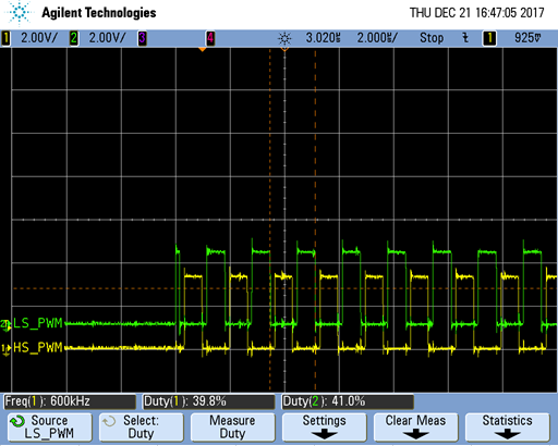

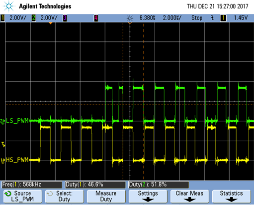

I am configuring a complimentary PWMs (high side adn low side) for a half-bridge converter.
The frequency and dead time are correct until the falling edge of the third EPMW1B(LS). The code for the EPWM is attached below. The complementary EPWM is generated from the dead band module.
I am wondering if the startup behavior of EPWM is controlled and which registers are related to?

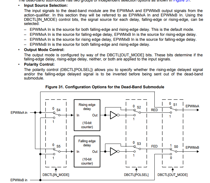

// Active high complementary PWMs - Set up the deadband
(*ePWM[n]).DBCTL.bit.IN_MODE = DBA_ALL;
(*ePWM[n]).DBCTL.bit.OUT_MODE = DB_FULL_ENABLE;
(*ePWM[n]).DBCTL.bit.POLSEL = DB_ACTV_HIC;
(*ePWM[n]).DBRED = 10;
(*ePWM[n]).DBFED = 10;

  • Tian,
    if you enable the PWM, then change the configuration of course thing will change. Try disabling the PWM output, fully configure the PWM, and then enable the PWM output. There are several ways to do this, one way is to configure the pin as a GPIO, configure the PWM, and then switch the value in GPxMUXy to enable the PWM's output.

  • Hi Cody,
    Thank you for your suggestion, I switched the GPIOs back to ePWM1A/1B after fully configured the PWM. The pwm pairs look ok to me.  In this way, the bad parts of  PWMs are manually masked, but I still have ePWM triggered SOC. The fist SOC may not be synchronized with the first good PWM pair. I will let you know if this is an issue.
