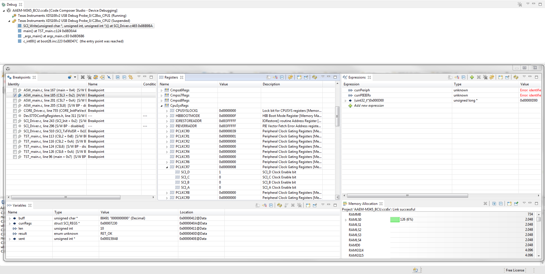

All registers work properly, but no Tx ISR trips.
I noticed that the PIE Vector table on CPU2 is not updated.
Where am I doing wrong?

  • Hi Vivek,
    I removed the following lines of code you reported me to be useless:
    Configuration of GPIOCtrlRegs.GPCSEl4.BIT.GPIO93 =0x2
    Configuration of GPIOCtrlRegs.GPCSEl4.BIT.GPIO94 =0x2
    I confirm that with the CPU2 I make all the configurations of the necessary registers, among which the writing of the clock register (CpuSysRegs.PCLKCR7).
    In our project we have developed drivers for the configuration of SCI devices that perform all the setups that must be performed by the CPU that wants to use the SCI.
    We have tested the operation of the driver for both the SCIA and the SCID: the CPU1 is able to use both the SCIA and the SCID.
    But when we try to use one of the two SCIs on the CPU2, for example the SCID, the SCID is not able to use it.

    On the basis of our debugging operations we have noticed that all the configurations carried out are successful and are written correctly in the registers of the CPU1 and of the CPU2. What we have noticed is that the serial interrupt routine related to the SCID used by the CPU2 is never executed. We also noticed that the CPU2 vectorTable does not seem to be updated. What can we have to do?

  • Hi Nicola,
    We do not have any restriction on usage by CPU2.
    If vector table is not updated then you'll not notice the interrupt. You have pie vector table initialization inside if condition. Have you checked that this condition is TRUE (RET_OK) ? Seems like some handshake issues between CPU1 and CPU2.
    Vivek Singh
  • Were you able to resolve this issue?
  • We have solved the problem originated by an apparent wrong behavior of the compiler (we have opened a thread for this) that did not allow us to set correctly the pin MUX of GPIO.
