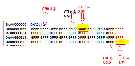

    after suggested solution of disabling source wrap and source transfer step to -3, it behaves the same as earlier. for more understanding i have attached the DMA buffer result and we can see below that the Data of ADC updated at DMA memory every alternate trigger of ADC and not every time.
    I'am really not sure that it is because of the ADC architecture in TMS320f28335 or still we can achieve the result by configuring DMA. is i misunderstood anything? i hope you understand the problem in this case clearly? Is it possible from your side to just run the example code and my updated code? it may give clear understanding if i could not be able to explain.
    Pritesh
     Is it the source address that does not appear to be wrapping properly?
  • Thanks for the memory snapshot. That helps. It almost looks like you're getting two DMA triggers for every sequence. Would you agree?
