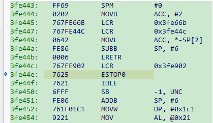

It works well for CPU1, that is after CPU1 watchdog reset, the PC of CPU1 will go to main() again. However, it works failed for CPU2. After watchdog reset of CPU2, the PC will go to 0x3fe44e which is a ESTOP0. At the meantime, CPU1 runs normally. Then I reset and restart CPU2 using CCS, the CPU2 can run again.

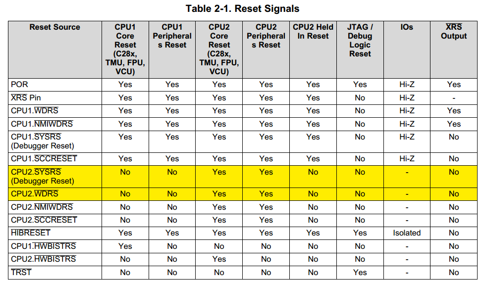

Question 1: what's the difference between CCS reset and watchdog reset for CPU2?
According to the TRM, the CCS reset and watchdog reset for CPU2 are the same shown below.
After watchdog reset of CPU2, why CPU2 doesn't go to main() again?
    Though functionally both reset look same the behavior will be a bit different. After debug reset CPU remains halted and when you restart, CCS will run the Gel file and force the PC with entry point so BOOT ROM may not run where as in case of WD reset, CPU will always run through BOOTROM.

    When CPU2 watchdog reset occurs, CPU1 executes above code successfully. But CPU2 still goes to 0x3fe44e which is a ESTOP0. The value at 0xD00 of CPU2 is 0x025A which means CPU2 will be in wait mode.
    I think the PC of CPU2 should never go to 0x3fe44e even in wait mode. So is there something wrong in my project?
  • Code you have written for CPU1 helps for standalone application. With debugger connected, you need to initialize 0xD00 with boot to flash setting. In my opinion if debugger is connected and CPU2 boots in waitboot then it'll go to ESTOP but I'll double check this and confirm.

    I have confirmed that this is expected behavior. If debuger is connected then CPU will stop at ESTOP if no valid BOOT mode setting (or it's WAITBOOT) is there.
