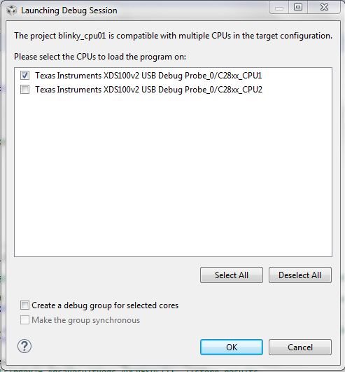

  • Hi Vamsi,
    Apologies for late reply, I was suffering through some health issues.
    Thank you for your quick reply. Although I am not able to understand the root cause here that why am I being shown the note which is stated in previous posts.
    I must add this:
    I have been working on a piece of code from few days which imports a few arrays through a function as given below

  • Rohan,
    Hope you are feeling better now.
    This note gets printed whenever the target is connected in the debugger.
    Are you using CPU2 as well in your application?
    Thanks and regards,
    Vamsi
  • Hi Vamsi,
    Thanks for the concern.
    No I don't intend to use CPU2
    I have just increased the array size that i am importing...
    and since then, i am seeing this note
    does this problem relate to memory sectorization?
    Can this problem be solved by extending some sectors ? say FLASH or RAMGx/Lx?

  • Hi Rajaravi Krishna Katta
    If you are using only CPU1, this note is not applicable.
    I am not using CPU2. I have imported a blinky project from C2000 ware and edited the main code. All the settings are kept unchanged.
    In the function 'lorlineshape', are you defining the arrays - v0, ST0, gamma_air, gamma_self, Ep? Or these are defined somewhere else and you are declaring them here?
    Yes these arrays are defined somewhere else (another '.c' file which is added in the project) and declared in this function.
     When you hit this function, can you check in diassembly in CCS, which instruction is hit before the program halts.
    I can send you the '.c' file of the code and you can debug it over there. that way it would be more convenient. and later on when you have some comments to share then you can simply post it in this thread rather than personally telling me.
    Here are the files -  main file and other file where the arrays are stored

    As you suggested, I have used the default linker file from C2000ware. (Actually I have created new workspace and downloaded new C2000Ware for a fresh start)
    And I have Debugged it with only CPU1
