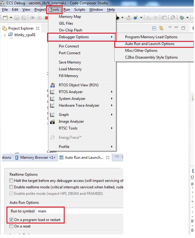

  • Hi Zou,
     I import "Example_2802xCpuTimer" project. No matter if I specify entry point to code_start or none, after loading the code or hit restart, the PC will stop at the beginning of main().
    That is because in CCS by default settings are such that CPU stops at main() after restart or code load. You can check (or change) this setting in CCS under Tool -> Debugger Options -> Auto Run and Launch Options
     Besides, can i say that the symbol management entry point will only influence what code behaves when I'm debugging with CCS, if it's load to flash and run alone, it will not influence anything, right?
    That is correct.
