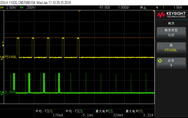

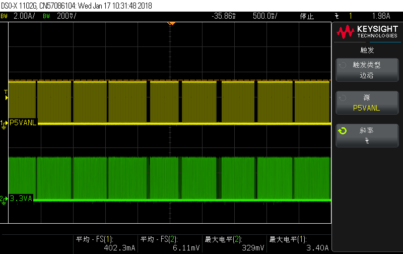

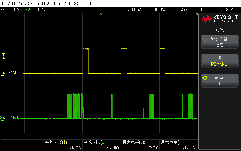

Customer targets to received command from host every 1ms, and then reply 168bytes contents 60000 times.
They use host program to receive the reply and calculate if it's communicated correctly, while the problem is, they always get missed message, which is every 500ms, there will be 40~50ms without data transmitted, and by further confirmation, it seems to be F28377D doesn't send even if Tx is enabled after FIFO is written to.
Could anyone please help to check the code and advise if we missed anything, or point out where the problem is?

    If buffer write after check the space is more than 168, then the ui32TxCountNum is the right number 168*60000, in this case, the byte number received by the serial port tool is same as the MCU sent, so it looks ok, but if we checked the oscilloscope, we found that every 500ms, there will be 40-50ms with no data transmitted as picture 1 below, yellow signal is GPIO92 when space is more than 168, green signal is USB data.
    Picture 2 - zoom in the interval, it's 40-50ms, only SOF packet in the USB data signal.
    Picture 3 - the start of interval, there are 2 times to write data to FIFO, and no date in USB data signal, g_sTxBuffer buffer size UART_BUFFER_SIZE set to 512 and in usbdcde.c FIFO size DATA_IN_EP_FIFO_SIZE set to  USB_FIFO_SZ_256, normally it needs 3 times to fill it full since 168*3=504<512bytes, while in this case, it looks only filled twice.
    Picture 4 - it's the end of interval, it looks the USB data signal occurs 3 frames, then the last two GPIO92 fill Txbuffer and USB data signal looks ok.
    From these pictures, this issue looks MCU filled the data into FIFO and after 40-50ms, the data send to USB data signal but it took a long time.

    If you are only seeing SOF packets in the 40ms-50ms, this makes me think that the issue is the host serial port tool. It may not be sending DATA IN request packets during that interval. If this is the case, then the device will not be able to send the data to the host since it is not sending the DATA IN packets.
    Since you are trying to use blocking/looping to eliminate the interrupts, you will need to dig into the USB library, and particularly the USB driver to see when the interrupts are being re-enabled. You made it seem like the interrupts are being re-enabled in the USB library. It is likely occurring at the USB driber level (usb.c / usb.h) set a breakpoint where they are getting re-enabled and you can see what is going on and how you should modify it.
