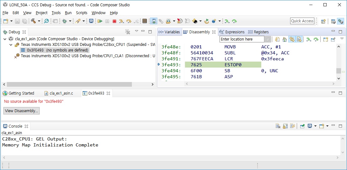

4. After ramfunc=on, when i started processor It halts. messaging "No source available for "0x3fe493" "

8. When program loading the state is as below

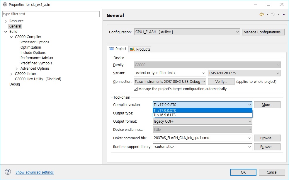

9. My compiler versions are as below ( I tried both of them)
