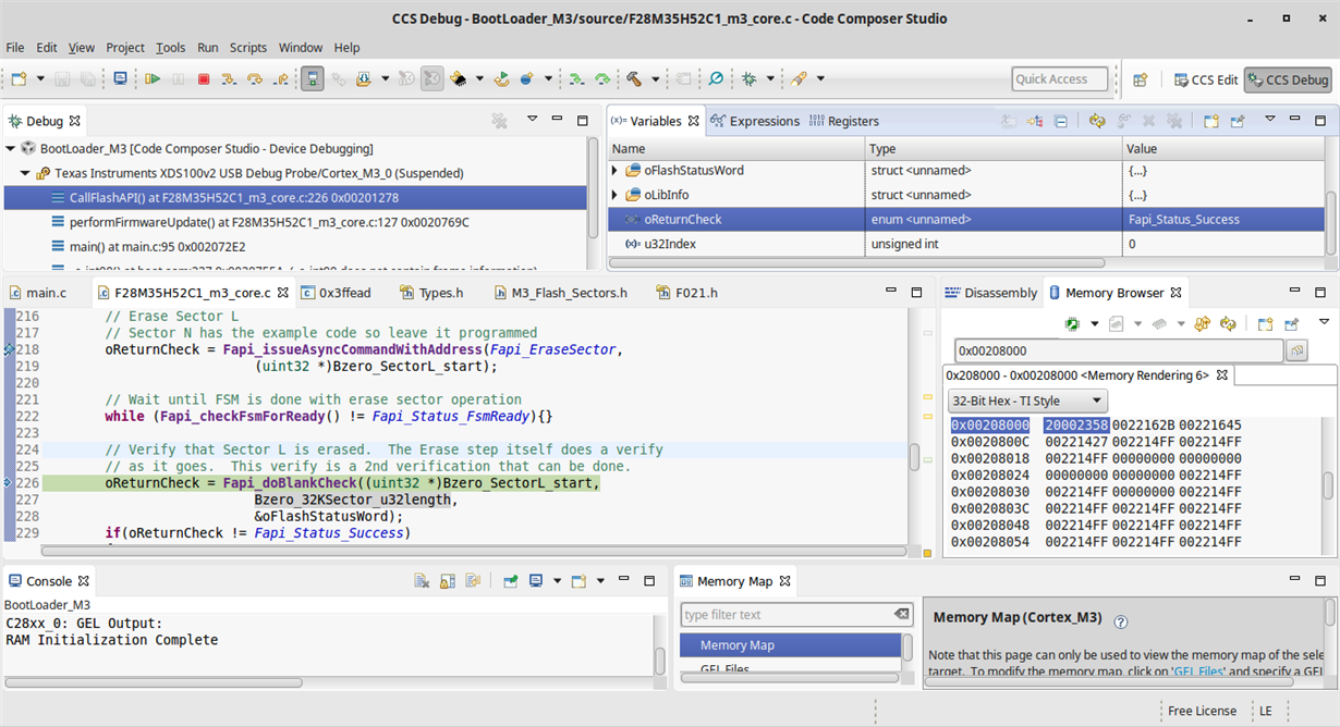

I am trying to have Flash API function Erase one of the sector of M3 Flash Memory (Sector L). I have followed all the necessary steps suggested in the FLASH API application note and using the same set of F021 Libary and functions used in one of the Control suite example.
I am particularly having challenge when software execution passes Fapi_issueAsyncCommandWithAddress(Fapi_EraseSector, (uint32 *)Bzero_SectorL_start) and passes the while condition after this. When i observe the memory browser for Sector L, I do not see it getting flashed but it still retain the same code.
Below are some screenshots of what i have been observing while trying to erase the sector.
Here the function i call to perform some Flash operations.

Also i configured the M3 for 75Mhz frequency.
Any hints on what i could i be doing wrong ??
Preetham,
Please search for "What are the common debug tips that we can consider when Flash API fails to erase or program?" in the Flash API FAQ page: http://processors.wiki.ti.com/index.php/C2000_Flash_FAQ
It may be that you are not claiming pump semaphore for M3 before calling Flash API functions - I did not see it in your code.
Thanks and regards,
Vamsi
Preetham,
Are you able to erase any other Flash sectors? If yes, it might be a security debug - you can check GRABSECT and password locations to know if that sector is secured. If it is secured, you have to either unlock it or execute Flash API from the RAM that belongs to the same secure zone as that of the failing sector.
Thanks and regards,
Vamsi
