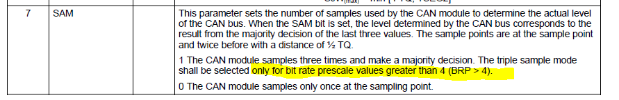

I have a question about SAM and BRP bit field in CANBTC configuration.
CAN module reference guide says that BRP>4 is required for SAM=1 configuration in the below table.
I want to understand what would happen if SAM=1 and BRP <=3 instead of BRP>4 for some reason.
Could anyboytell me that?
