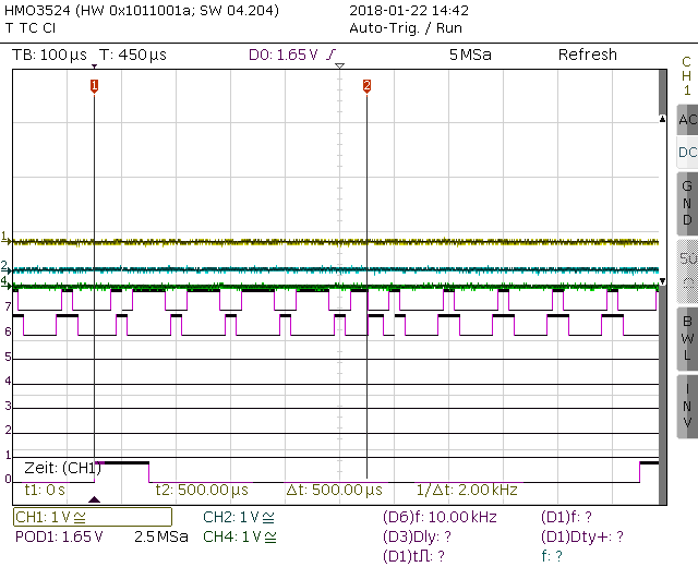

I wanted use the OUTSWAP feature with shadow of the deadband module of my device. But it seems that the OUTSWAP bits are not shadows while the others are.
Should this bitfield be shadowed?
For testing run a ISR at CTR=PRD (up-down counting mode), while reload of DBCTL is configured to CTR=0. So I would expect that the signals do not change when the ISR is executed.

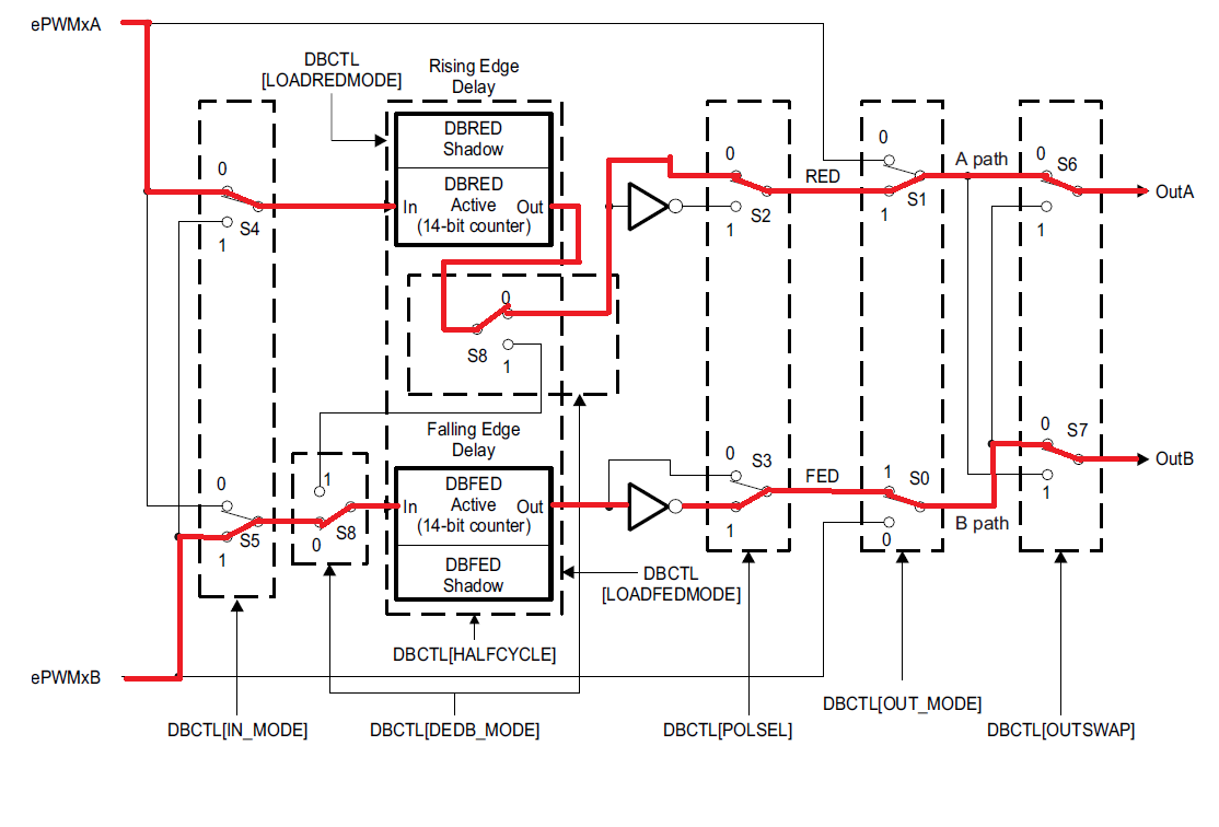

The dead band generator is configured as shown in the following link, but S3 is set to one.
The delays are set to zero, so effectivly ePWM1A is passed to the point RED and ePWM1B is inverted and passed  to FED.
ePWM1A has a smaler duty cycle that ePWM1B to visualise the signal.
Where the left cursors sits this is executed:
//          EPwm1Regs.DBCTL.bit.OUTSWAP = 0x3; (swap outputs)
//          EPwm1Regs.DBCTL.bit.OUT_MODE = 0x3; (enable inversion of B)
          EPwm1Regs.DBCTL.all = 12331;
and at the right cursor:
//          EPwm1Regs.DBCTL.bit.OUTSWAP = 0x0; (unswap outputs)
//          EPwm1Regs.DBCTL.bit.OUT_MODE = 0x0; (disable inversion of B=
          EPwm1Regs.DBCTL.all = 40;
As you can see on the scope the outputs are swaped immediately at the cursor, while the inversion of B occurs 50us later at CTR=zero.
CH7 =B
CH6 = A
Thomas.

    That line:
    should say:
    The dead band generator is configured as shown in the following link:

    This is interesting. Are you using up-count mode? Can you share your action qualifier settings too? I am just trying to ascertain where the CTR = 0 event might be occurring on the waveform.
    Thanks.
    Hrishi
  • Hi Hrishi,
    I used up-down counting mode.
    CTR = 0 alligns with the scope grid.
    The pulse in CH0 (bottom left corner) is a GPIO which ist set and reset in a IRQ at CTR=PRD.

  • Hi Thomas,
    Sorry for the delay. Here's what I got back from design:
    Note: Shadowing is applicable for bits [5:0] of DBCTL. Other bits are not affected by shadow load operation.
    This means that the behavior you've reported is expected.
    Typically it is not recommended to swap the two outputs during operation. If it must be done, I recommend implementing it during a 'quiet' time of the operation when there's no switching or when the outputs are in the same state.
    I hope this helps.
    Hrishi
