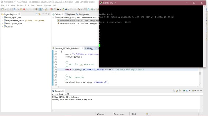

  • Dear Sal Pezzino:
    I have attached a screenshot of the error as below:
    As you can see, I have tried giving an input character “t”, but there is no returning echo from the microcontroller (returning echo supposedly prints "  You sent:" together with echoback, based on my understanding of the code).

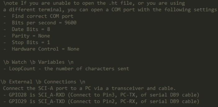

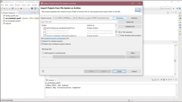

    This code was imported from C2000Ware examples, as shown below:

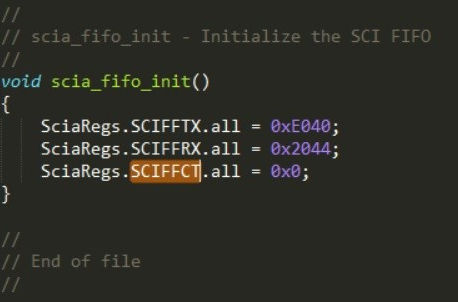

    Following screenshots are the configuration I have followed from the example:
    Is there any further configuration required apart from the details commented/mentioned in the example C file?

  • Are you using the controlCARD?
    I am not seeing this issue. You need to use a oscilliscope to ensure that the device is seeing the character which is being transmitted to it. You may have a problem with your RX pin.
    You are able to transmit from the device. But not receive properly.
    Are you seeing any data in the SCIRXBUF register?
    sal

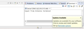

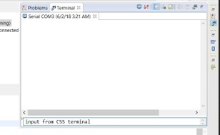

  • Dear Sir,
    I’ve tried using the terminal, but still having issue with UART whereby the board does not receive input. Attached are screenshots illustrating my tests:
    I connected the UART cable to TMS320F28075 via the controlCARD (pin 76 and 78 on the docking station), the RX pin still does not receive any messages. Note that the board is running the echoback example code in our previous discussion.
    However, when I tried the same configuration with an Arduino acting as relay/intermediate such that PC->Arduino->TMS->PC, the message can be received correctly as shown below. (RX pin received messages from Arduino)
    It seems like both the RX pin on the control board and the UART-USB cable are functional, but I somehow can’t send the message to the board whenever I connect it directly from my PC.
    Any suggestion and insight on troubleshooting this issue is much appreciated. Thank you.
    I suggest using a scope to ensure that the data is being transmitted to the controCard. Also, make sure you have configured the correct GPIO pins which you are using for SCI communication.
