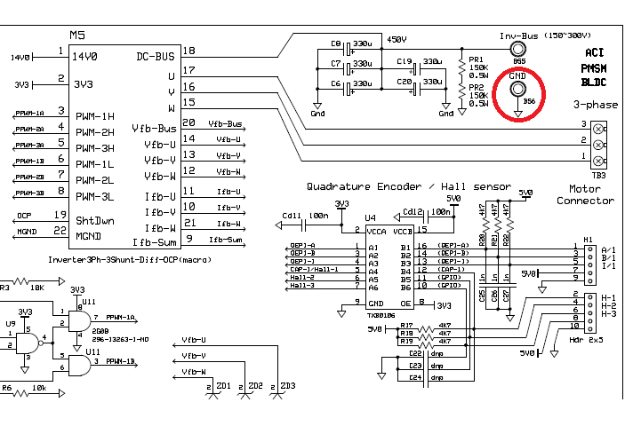

Is it possible,having two Motor control kits(TMDSHVMTRPFCKIT) , connect them together according Active Front End (AFE) + Inverter scheme?
Thank you for any help,
Andrey
  • Yes, it's ok. One is a inverter for motor drive, another one is a converter. The converter need to add the inductor on each phase as you showed above. But you should be noted that the power module only supports the maximum pwm frequency is 20kHz.

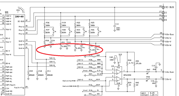

     But we have all our mesurments relatively to negative potential of DC bus.
    When we work in  AFE mode, negative potential of DC bus has a fluctuation depending on semiconductors state(opend or closed).
    It will resulti something like this(output invertor voltage (AFE+invertor modeling))
    Here voltage has a constant offset and can be compensated.  But will this offset be constant in real situation? Can we restore original values for feedback control?
  • You can refer to the DC/AC reference in controlSUITE as below, you need to change the voltage sampling circuit if you need the voltage feedback and use the inverter as a DC/AC.
    \ti\controlSUITE\development_kits\HV_1PH_DCAC
  • It is not feasible to use the design as a AFE, because of the sensing issue, missing inductor etc.. you will be better of designing your own hardware.
