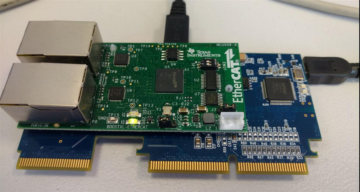

i´m working with Codesys V3.5 SP11 and the TMDSECATCNCD379D ET1100 (EtherCAT Slave and C2000 Delfino MCU controlCARD Kit).
This are my configurations on the board:
In this pic the ethernet cable to the PC is removed. Normally it is plugged into PORT0-IN.
I want to communicate between my Ethercat Master and the ESC but if i´m scanning for devices, Codesys doesn´t find the ESC.

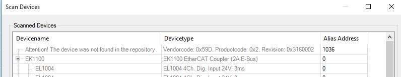

Thats what i get:
I already tried to include the ESI, which is in the Echoback Demo (TMDSECATCNCD379D EtherCAT slave (SPI).xml) but the Productcode und Revision doesn´t fit to the ESC i have.
In the documentation it´s all described for TwinCat3. Maybe for Codesys i have to do other steps?
