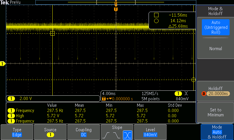

I have designed a board(called test board) with 28335 CAN interface,whose principle shows above. The serial port function and lights and other functions of the test board are normal, the emulator's connection of the test board is normal,too.
The CANA interface of the test board uses the pin GPIO18 and GPIO19, The CANB interface uses the pin GPIO12 and GPIO13.I have connected CANA + with CANB+, CANA- with CANB- ,and there was a 120Ω resistor in in parallel with CANA + and CANA-,in my CCS project, I set CANA to send 0X55555555 and 0XAAAAAAAA, CANB to receive and found abnormalities, which described as follows:
1、 I have bought a development board with 28335, too(called development board), and the same CCS project runs in the development board normally , the TXD waveform of the development board is shown below:
The CANA and CANB interface pin of the test board and the development board are same, but the CAN interface of the test board is abnormal, that the TA bit of the CANA can not be set.
2、 I have tried another GPIO like GPIO30 and GPIO31 ,the CANB transfer to the CANA, which performed the same.The waveform of the TXD pin is showen below:
3、 I have compared the difference between the test board and the development board, found that the chip screen is different, the test board chip lot number is G4A,and the development board chip lot number is CA, as shown below:
So I wonder why is that happen?

                Please download my app.note SPRA876B from the TI website and go through the section titled "Debug checklist". In fact, examples in that app.note was developed on a F28335 device and you should be able to run any example from that app.note "as is".
    Since your project runs fine on the "Development board", it is reasonable to assume this is a hardware problem in your "Test board". Have you compared the schematics of the two boards? I presume the Test-board has isolation (ADUM1201), whereas the Development-board does not.
    In the "Test board", you talk of a 120-ohm resistor between CANA+ and CANA-. How about a resistor between CANB+ and CANB-? Remember a bus needs to be terminated on both ends.
    The fact that TA bit is not set indicates that the hardware connection between the two CAN ports is not good.
    The "chip screen" (or package symbolization) has nothing to do with your problem. The two devices are functionally identical.
  • thank you for reply,I finally get out ,there were unwanted capacitance between CANH\CANL and gnd, which caused the problem.
  • Glad your problem is resolved, but could you explain further? What exactly was the source of this "unwanted capacitance" and how did you eliminate it?
