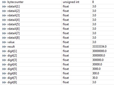

Hello all,
I have written a program which communicates with a pc interface via sci. Sci sends my launchxl some chars and I need to convert those into integer/float etc.
Just math.h is included.
I have some problems with these calculations. The subroutine below is being called by a for loop for every sci character I get. I know it is not the best char to number converter algorithm but anyway. :)
int whatcomesnext=0;
Uint16 bytecounter=0;
Uint16 sdataA[8];
Uint16 rdataA[8];
Uint32 result=0;
float32 value;

"value" is always correct but "result" is not. When I send 11111111 or 22222222, it is ok. Result is correct. But for 33333333, result becomes 33333334. For 99999999, result = 100000000.
So I need a correct result and according to my result, I will divide and get another value. (33,25 or 77,358 etc. Some float parameter values)
I think math.h is not enough. I have read CLA and IQmath but could not use them properly. What do you suggest to improve the calculation accuracy?
  • 3333333"4" :) 4 how?
  • Uint16 sdataA[8];
    Uint16 rdataA[8];
    Uint32 result=0;
    float32 floatResult;
    Uint32 value;
    Uint32 divider;
    float32 division;
    Converting to Uint32 solved my problem. But now I have this :
    floatResult = result;
                                        division = floatResult/divider; // invokes FS$$DIV
    I need to convert Uint32 to float32.
    But result and floatResult becomes different. Any suggestion?
  • John,
    I think you are approaching the problem at hand in quite a difficult manner, if you really just want to transmitt float data, the SCI does not care if those are bits have float or fixed data , you really do not need to do what you are are doing..
    For example i can point you to routines where we communicate to the PC, and have float data..
    C:\ti\controlSUITE\libs\app_libs\SFRA\v1_10_00_00\GUI
    Unfortunately , I do not have documentation for it and you will need to spend some time to understand the code. However the point i want to make is that comms protocol do not care if it's float or fixed data for them they are bits and you don;t necessarily have to tramsit things as char's and interpret them ... you will be much more efficient designing the packet such that you can accomodate 32 bits data and then use a decode based on your packet whether it's float or fixed.
    Now to answer your specific questions:
    Float representation is 32 bit on C2000 MCU, so some of the rouding errors you are seeing are expected for such large numbers..
    I am not surprised by the floating point result that you are getting... you will have to switch to 64 bit floating point, but then as well conversion from int to float is not guranteed to be exact... though then error might be further down in the decimal point...
    here is a good one for you to refer
    www.ti.com/.../spraan9a.pdf

  • By the way, when I test "atof" function for some float values, it also is not accurate.
    converter = atof ("1.2");         // (converter shows : 1.19999993)
  • John , I had been out this entire month for personla and business related travel so trying to touch back on this topic.
    1. The inaccuracy you are refering to with atof will also be expected, in floating point there is no exact representation. Some rounding errors are expected and always present.
