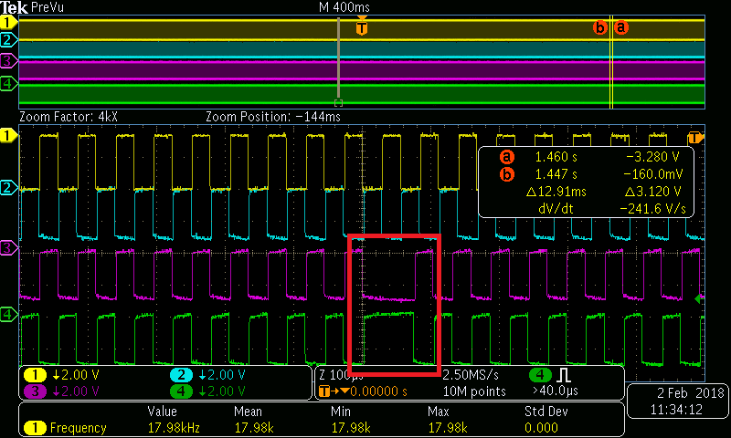

Dear,
I have a full H-bridge to control. I use ePWM1 and ePWM2 for this.
ePWM1 is used for one branch and has phase shift zero.
epWM2 is used for other branch and the phase shift is variable to set the duty cycle.
When I change the phase shift of ePWM2 the ePWM2 losses one cycle?
I change the phase shift by using EPwm2Regs.TBPHS.half.TBPHS.
Is there something I forgot to set-up?
This is the configuration I use:

Changing the parameters of the control is done like this:
period=11111;
      EPwm1Regs.TBPRD=(uint16)period;
      EPwm1Regs.CMPA.half.CMPA=(uint16)(period>>1);
      EPwm2Regs.TBPRD=(uint16)period;
      EPwm2Regs.CMPA.half.CMPA=(uint16)(period>>1);
      // Set phase in clock pulses according ° setting
      EPwm1Regs.TBPHS.half.TBPHS=0;
      EPwm2Regs.TBPHS.half.TBPHS=(uint16)(period*(uint32)Phase/360);
  • Hi Bart,
    This isn't the source of the problem but based on the ".half.TBPHS" in your post it appears you are using an outdated version of our header files.  Please make sure you are using the latest from controlSUITE / C2000Ware.
    The problem is happening because you are setting your PWM output high on TBCTR = 0.  When you have a TBPHS > 0 the TBCTR is immediately loaded with that value on the next SYNCIN and TBCTR = 0 is skipped until the counter overflows.
    The best way to do this is to use two compare events (CMPA and CMPB) to control the PWM output.  You want to make sure that your compare values are always greater than TBPHS or that you handle the PWM output through another software means, such as an action qualifier force, if one of the compare values is less than TBPHS.
    Kris
  • Dear,
    Thank you for the response. My problem is solved by changing:
    to
    EPwm2Regs.TBPHS.half.TBPHS=period - (uint16)(period*(uint32)Phase/360);
    found this solution on the example in:
    www.ti.com/.../sprug04a.pdf
    Thanks again.
