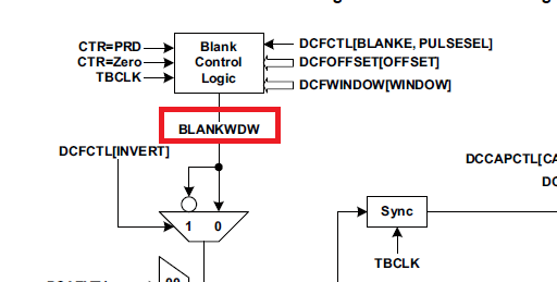

I'm searching for an C code example of the new blanking capability of the CMPSS (type 1).

Hi Holger,
We don't have a blanking window example. However, it's really nothing special. From the cmpss's perspective, it's basically a "pwmsync" signal with a configurable pulse that comes from the digital compare submodule of the epwm.

Hi Holger,
Since EPWMBLANK doesn't belong to the CMPSS, there won't be a detailed description of it in the CMPSS chapter as this would be just duplicate information from the EPWM chapter. The CMPSS chapter in question will be expanded to something along the lines of the below highlighted. Note that the wording is preliminary and could change slightly.
16.6.1 LATCHCLR, EPWMSYNCO and EPWMBLANK Signals
The LATCHCLR signal clears the synchronize block, digital filter and the latch. It is activated in software
using xLATCHCLR(x= “H” or “L”). It can also be activated by EPWMSYNCO when xSYNCCLREN(x= "H"
or "L") is set. If a longer LATCHCLR signal is required, the EPWMBLANK signal can be used to extend it
by setting BLANKEN.
EPWMSYNCO and EPWMBLANK (BLANKWDW) come from the Time-Base and Digital Compare submodules of the EPWM. For a detailed description of how these two signals are generated, refer to the respective submodule chapter of the EPWM.

thx for the answer. Still customer has some questions:
- It is not clear which signal is referred to the PWMBLANK signal
- It is not clear how a edge control signal at the red marks position (see attached) will work.
