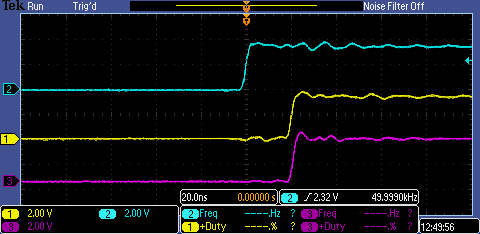

I am attempting to synchronize EPWM1-3 for a three-phase 208V inverter application. I followed the example code provided in ControlSuite (VSI - 1phase HP DC/AC), a modified the EPWM setup scripts. However, when I think I setup the EPWM IAW Chapter 14 of spruhm8g.pdf, I see a 20 ns delay in EPWM 2 and 3 from EPWM 1 (scope plot shown below, and option 1 in code snippet). Is this considered synchronized? If not, did I not setup the EPWM registers correctly?

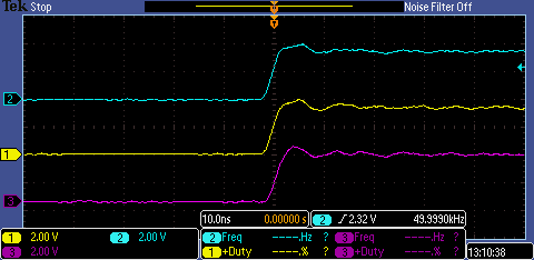

Also, when I setup the register in an alternative form (option 2 in code snippet), similar to that provided in the f803xPWM.h file that accompanies the three-phase motor control kit, I can get the three PWM pulses to line up exactly, but it doesn't appear to be IAW with the f28337xD documentation.
Both cases give the correct output duty cycle and frequency. Any insight is appreciated.

//Option 1 - Similar to TI documentation for f28377D
(*ePWM[inv_pwm_no]).TBCTL.bit.PHSEN = TB_DISABLE;
(*ePWM[inv_pwm_no+1]).TBCTL.bit.PHSEN = TB_ENABLE;
(*ePWM[inv_pwm_no+2]).TBCTL.bit.PHSEN = TB_ENABLE;
// configure PWM 2 and 3 as slaves and let it pass the sync in pulse from PWM1
(*ePWM[inv_pwm_no]).TBCTL.bit.SYNCOSEL = TB_CTR_ZERO; // sync "down-stream" - like example document, but gives phase delay on scope
(*ePWM[inv_pwm_no+1]).TBCTL.bit.SYNCOSEL = TB_SYNC_IN; // - like example document, but gives phase delay on scope
(*ePWM[inv_pwm_no+2]).TBCTL.bit.SYNCOSEL = TB_SYNC_IN; // - like example document, but gives phase delay on scope
//Option 2 - similar to f2803xPWM.h with 3-phase motor control kit
//(*ePWM[inv_pwm_no]).TBCTL.bit.SYNCOSEL = TB_SYNC_IN; // all set equal - pass through - this is how motor controller did it
//(*ePWM[inv_pwm_no+1]).TBCTL.bit.SYNCOSEL = TB_SYNC_IN; // all set equal - pass through - this is how motor controller did it
//(*ePWM[inv_pwm_no+2]).TBCTL.bit.SYNCOSEL = TB_SYNC_IN; // all set equal - pass through - this is how motor controller did it
//(*ePWM[inv_pwm_no]).TBCTL.bit.PHSEN = TB_DISABLE;
//(*ePWM[inv_pwm_no+1]).TBCTL.bit.PHSEN = TB_DISABLE;
//(*ePWM[inv_pwm_no+2]).TBCTL.bit.PHSEN = TB_DISABLE;
