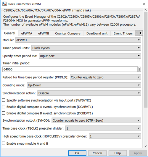

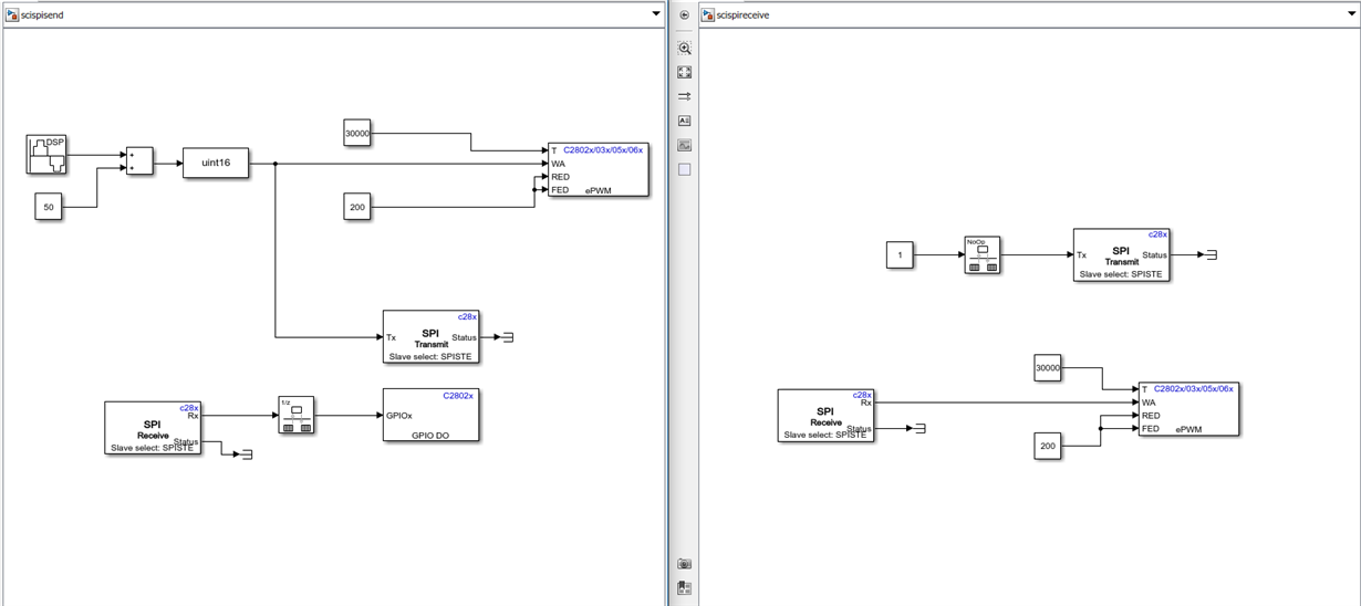

For my masterthesis I'am using the LAUNCHXL-F28027F with Simulink Matlab to implement my control algorithm. What want to do is having one LAUNCHXL-F28027F as a master device, it will be connected by an SPI bus to multiple LAUNCHXL-F28027F in a daisy chain. For the application it is important that they are synchronized and have a determined phase shift to each another. So I thought I approach my problem step by step by only using one LAUNCHXL-F28027F and control the PWM1 and PWM2. The was in a first step to synchronize them and then add a phase shift. I set up the following model in Simulink for the MCU:

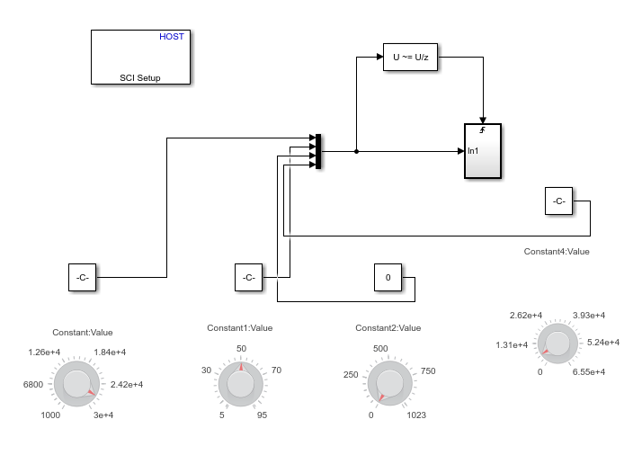

I control the frequency, duty cycle etc trough the SCI communication bus from my laptop with the following model:

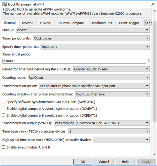

When the model is running I can adjust everthing apart of the phase shift of the PWM channels. here are the settings of the PWM blocks:
What am I doing wrong? and for the next step how can I proceed the Synco trough SPI to the other MCU?

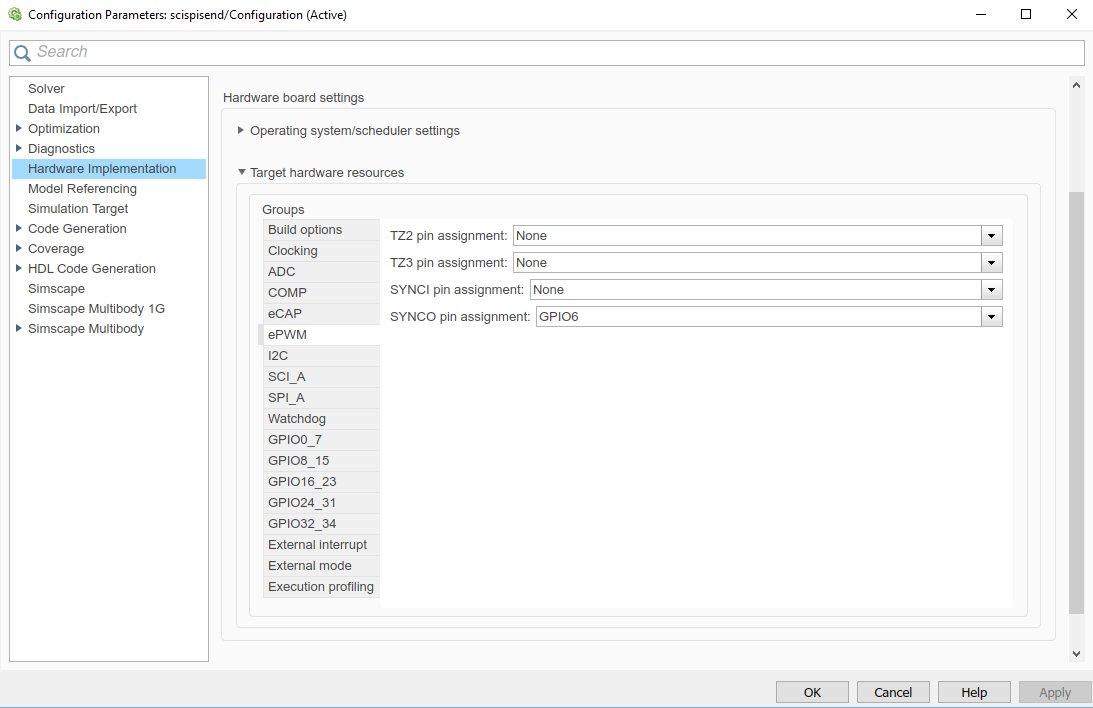

    The problem is that I still will use the SPI for duty cycle and other information, therefore J6.7, J6.8, J2.6 and J2.7 cannot be used. The only pin therefore is J2.8 but i getting now signal out of the pin if I measure it with the oscilloscope. What could be the problem?
    Here the setup on Simulink:
    Thank you for your help!
    Oliver

    Sorry for my late response. The solution was a lot simpler. I had to go into the hardware configuration and assign the pin. Otherwise it wont work. I experienced similar problems and I am running into problems with scheduling again.
    At the end it is my problem as I am really bad in C programming and not an embedded programmer. But it would help me a lot if there would be a good manual for the Simulink TI programming.
