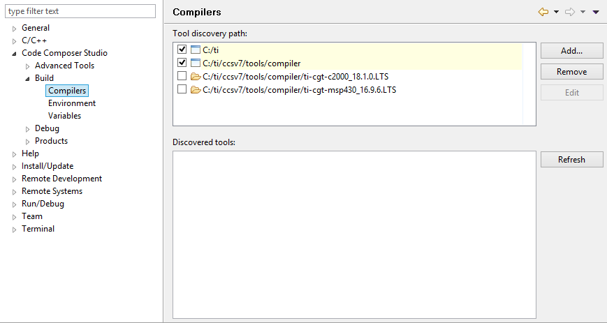

My problem is I couldn't select the compiler in the compiler list but i downloaded all the compilers
The steps which i followed is
  • Select 'Windows->Preferences...'
  • Expand the 'Code Composer Studio' node in the left pane
  • Expand the 'Build' node in the left pane
  • Select the 'Compilers' node underneath.
But i couldn't see any compiler name in the "discovered tool tab" which is under "tool discovery path" tab.

    Herewith I attach my screenshot of CCS(compiler section)for your concern and looking for a solution from your side.
    The operating system which i use is WINDOWS 8.1 Pro 64-bit OS.

    If the CCS installation was successful (as seemed to be the case by looking at the Installation History), it is very strange that the compiler tools are not listed under "Discovered tools". Could you confirm first that the compiler tools are actually installed inside the C:\ti\ccsv7\tools\compiler directory?
    Have you tried restarting CCS since the installation? If that does not help, would you mind trying a reinstall? You could even leave the current installation as-is (to delete later, if needed) and try the installation again in a different directory.
  • Yeah I confirm that the compiler tools are actually installed inside the C:\ti\ccsv7\tools\compiler directory.

    CCS should work just fine on 64-bit Windows OS (in fact most customers and folks within TI use it in a 64-bit OS environment), so that is not the issue. There must be something else in your specific environment that is causing an issue, but I can't tell what it could be, especially since it seems like the installation completed fine and the compiler tools also installed properly.
    When you create a new CCS project from menu Project->New CCS Project and select the F28335 device, does it default to a compiler version?
