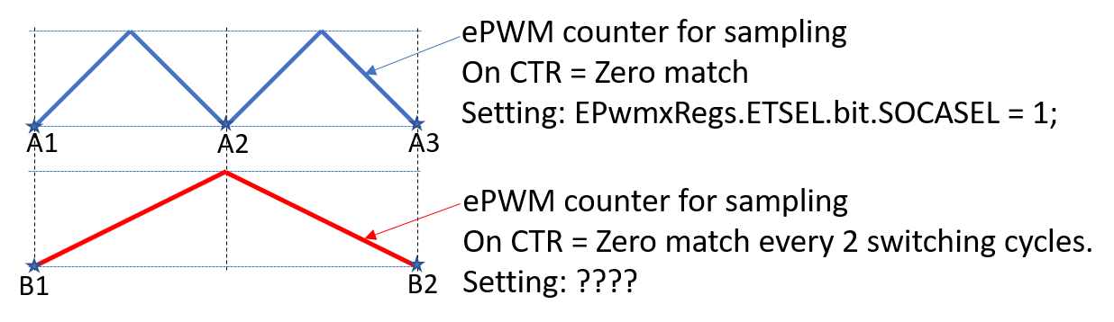

In my circuit, the switching frequency is 300kHz, so the switching time is 3.3us.
SOC starts on the epwm CTR=0 match,  so ADC happens every switching cycle. Please see below the blue one, which is ePWM counter, and at the time of A1, A2, A3, SOC occurs.
I think my time is not enough, so I want to do ADCs every 2 switching cycles. Please see below the red one, which includes two switching cycles or 2 original ePWM counters. How to do it or what is the settings?
Thanks!
  • Is this right if I make the following setting? Does this mean the SOCs occurs every 2 switching cycles? I don't know how to check to see if it is right or not?
    EPwm10Regs.ETPS.bit.SOCAPRD = 2; //Generate pulse on 2st event, 150kHz sampling freq.
    Do I miss some settings? -Thanks!

  • Hi Hongmei,
    Yeah, the ETPS is what you want. This should let you scale the frequency of the trigger events.
