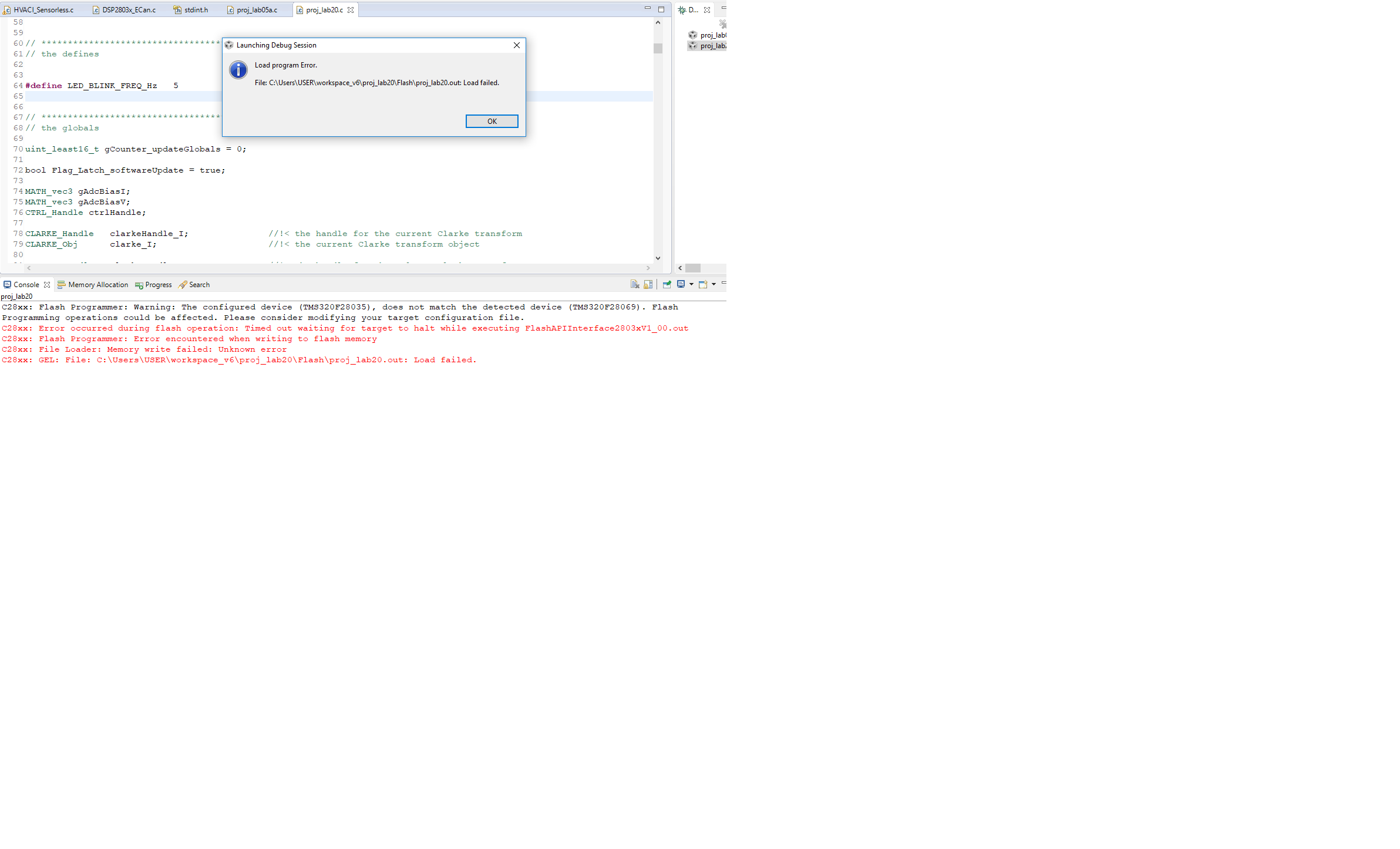

We are using LAUNCHXL-F28069M + BOOSTXL-DRV8301.
but while debugging any lab in motorware in CCS Version: 6.1.0.00104
it is giving following error.
How to resolves this error.
Switch connection on launchpad: All keys ON
Thanks.
Sameer,
the cause is that instaSPIN code contains some non-debuggable code. The best way to resolve your issue is to put the device in wait-boot mode, this requires that you configure switch S1 (0,1,0) and then reset the device. This will keep the device from running the code that is blocking you from re-flashing the device.
