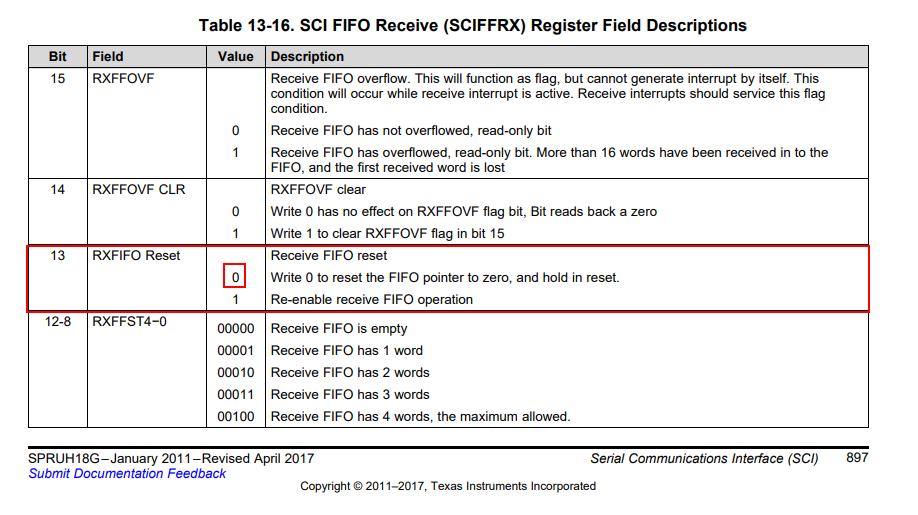

    ScibRegs.SCIFFTX.all=0xE040;
    ScibRegs.SCIFFRX.all=0x0042;
    ScibRegs.SCIFFCT.all=0x0;
    ScibRegs.SCICTL1.all =0x0023;  // Relinquish SCI from Reset
    SciaRegs.SCIFFRX.bit.RXFIFORESET=1;
    SciaRegs.SCIFFTX.bit.TXFIFOXRESET=1;

This is the receiver function, but the compiler stuck in line;  while(ScibRegs.SCIFFRX.bit.RXFFST == 0)
void sciReceive(Uint32 length, Uint8 * data)

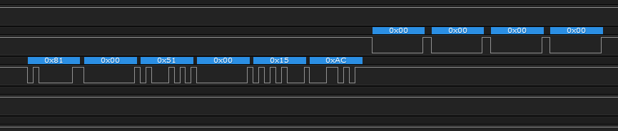

I made sure that the coming signal is ok by logic analyzer.
Here is the response can be seen from the device. 4 Bytes 0x00 Data.

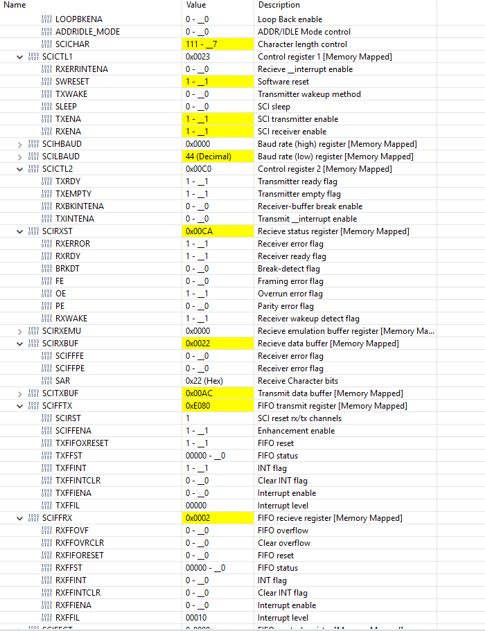

And Here is the SCI-B Registers
