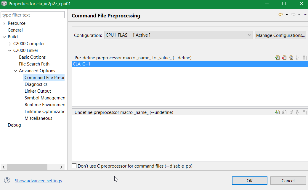

    Are you using another linker command file in your project? Or only 2837xS_FLASH_CLA_lnk_cpu1.cmd?
    If you are using 2837xS_FLASH_CLA_lnk_cpu1.cmd, you should make sure that CLA_C=1 is predefined in your linker settings like the example shows.
    There is no problem with PAGE 0 being used. I think this is just a minor error with the linker file in your project.

    thanks for your fast reply. I first tried my own linker file (derived from your examles) and then tried the example file 2837xS_FLASH_CLA_lnk_cpu1.cmd to verify the error I got. And YES, I get the error noted above with CLA_C=1 defined. Without CLA_C=1 I get

     - predefine CLA_C=1 in linker
