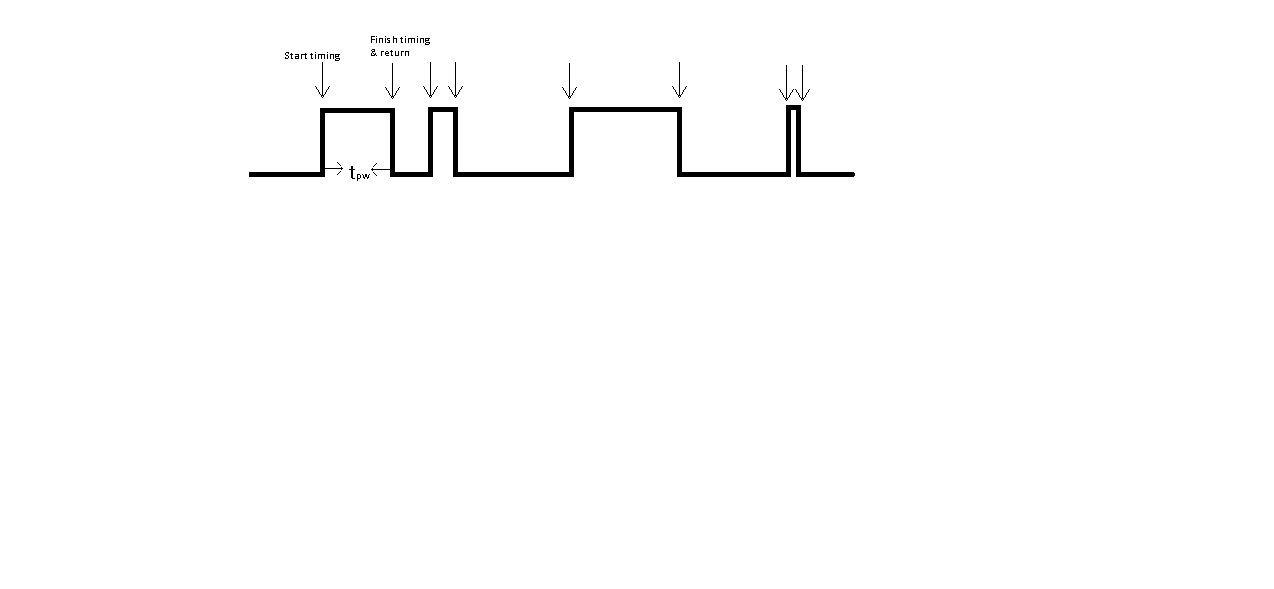

  • Hey Tommy!
    I hate to bug you more, but i'm having trouble understanding just exactly how this works. This is is my 2nd microcontroller as im just as 2nd year student, but I have some questions regarding this, and I hope you can help me! If not, just let me know and I'll post a new thread!
    We're trying to set it up like this:
    We just want to measure t_pw.
    We've set up ECCTL1 as so:
    ECap1Regs.ECCTL1.bit.FREE_SOFT = 1;          //stop after interrupt for debugging purposes
    ECap1Regs.ECCTL1.bit.PRESCALE = 0;  // no diviser
    ECap1Regs.ECCTL1.bit.CAPLDN = 1 // enable capture units
    ECap1Regs.ECCTL1.bit.CAP1POL = 1; // start timing on Falling edge
    ECap1Regs.ECCTL1.bit.CAP2POL = 0; // return value on Rising edge
    ECap1Regs.ECCTL1.bit.CAP3POL = 1; // start timing on Falling edge
    ECap1Regs.ECCTL1.bit.CAP4POL = 0; // start timing on Rising edge
    ECap1Regs.ECCTL1.bit.CTRRST1 = 1; //  after detecting a rising edge, reset the timer
    ECap1Regs.ECCTL1.bit.CTRRST2 = 1; //  after detecting a falling edge, return the value
    ECap1Regs.ECCTL1.bit.CTRRST3 = 1; //  this just shadows eCAP1, so shouldnt it reset when we reset CTRRST1?
    ECap1Regs.ECCTL1.bit.CTRRST4 = 1; //  this just shadows eCAP2, so shouldnt it reset when we reset CTRRST2?
    // CONTROL REGISTER 2
    ECap1Regs.ECCTL2.bit.CONT_ONESHT = 0; // continuous because we want to keep the timer running after the first edge (event)?
    ECap1Regs.ECCTL2.bit.STOP_WRAP = 3; // iwe just want the difference between the rising event and falling event so this doesn't matter?
    ECap1Regs.ECCTL2.bit.SYNCI_EN = 1; // Enable sync in
    ECap1Regs.ECCTL2.bit.SYNCO_SEL = 0; // Pass through
    ECap1Regs.ECCTL2.bit.TSCTRSTOP = 1; // Start Counter
    ECap1Regs.ECCTL2.bit.REARM = 1; // arm one-shot
    ECap1Regs.ECCTL2.bit.TSCTRSTOP = 0;        // Make sure the counter is stopped
    ECap1Regs.ECEINT.bit.CEVT4 = 1;            // 2 events (rising then falling) = interrupt, then we get the value
    ______________________
    Does this make sense?
  • Andrew,
    Next time, it would probably be best to start a new post, but no problem.
    In plain English what are you trying to do with the eCAP? Something like: I am trying to capture the on-time of every pulse. OR, I am trying to measure the duty cycle of the first pulse after an event "X".
    Reading through your comments it seems like you are a little confused on the function of the eCAP. Lets talk about a few of them.
    The polarity bit simply sets what event will trigger CAPx to capture the timestamp counter(TSCTR). It wont have any effect on " start timing" or "return value".
    These do not shadow CAP1 or CAP2. That functionality is only used when the eCAP is in APWM mode. This comment also makes it sound as if you are thinking of each of the CAPx registers as it's own timer. That is not the case, there is one time for the entire module and the CAPx registers simply store the value of the TSCTR when their even occurs.
    You have 2 options 1. One-shot mode: the eCAP module will stop after the modulo counter reaches the value in STOP_WRAP. In continuous mode the eCAP module will continue to operate after the modulo counter reaches the STOP_WRAP value, "wrapping" back to CAP1 and beginning to overwrite values.
    This determines if the eCAP will stop and wait an indefinite amount of time for you to read out the values or if it will overwrite the CAPx registers if new rising/falling edges are detected.
    I would recommend starting with an example and then reading the chapter so that you can understand what each line of code is doing. Luckily the eCAP is a very simple module and the chapter is verbose enough to explain of the finer details.
    Cody
  • Hey Cody!
    This has been a huge help! Essentially, we want to capture the width of a pulse produced by a sensor.
    We've decided on a system which will rotate through the 5 ultrasonic sensors and ideally, we'd like to use the difference function to determine the time between the first event and second event and then reset.
    We just have one more question! How do we 'reset' the event detection after we detect the 2nd event? I'll try to elaborate here.. We want to:
    1. Detect Cap1
    2. Detect Cap2
    3. Return the difference (also, which register is the difference stored in?)
    4. Use the difference to evalaute stuff
    5. Select the next sensor (which we can handle)
    6. Repeat
    Our problem right now, is the fact that we have Cap 3 and Cap4 that we'd like to ignore if we can!
    Thats our issue right now! I really do appreciate your help! We are definitely stressed about getting our capstone project done in time, and you, and youre co-workers are really helping us out quite a bit, which is awesome!
    Thanks!
    Andrew
  • Andrew,
    The first thing you need to do is choose Continuous mode or One-shot mode.
    You can disable CAP3 and CAP4 if you modify the STOP_WRAP value.
    The eCAP doesn't automatically return the difference. When read, it returns the value of the TSCTR at the time of the event. If you want to save time and avoid preforming "CAP2-CAP1" in your code: You could setup the eCAP to clear TSCTR at CAP1's event and then the stored value in CAP2 would be the difference between these events.
    I know the eCAP looks daunting, but it's actually a simple module!! I would estimate that you could understand 95% of the eCAP's functions with ~4 hours of working with examples and reading the manual... Which may be faster than asking questions on the forum.
    Look into the registers I mentioned above and if you have more questions keep them coming!
    Cody
