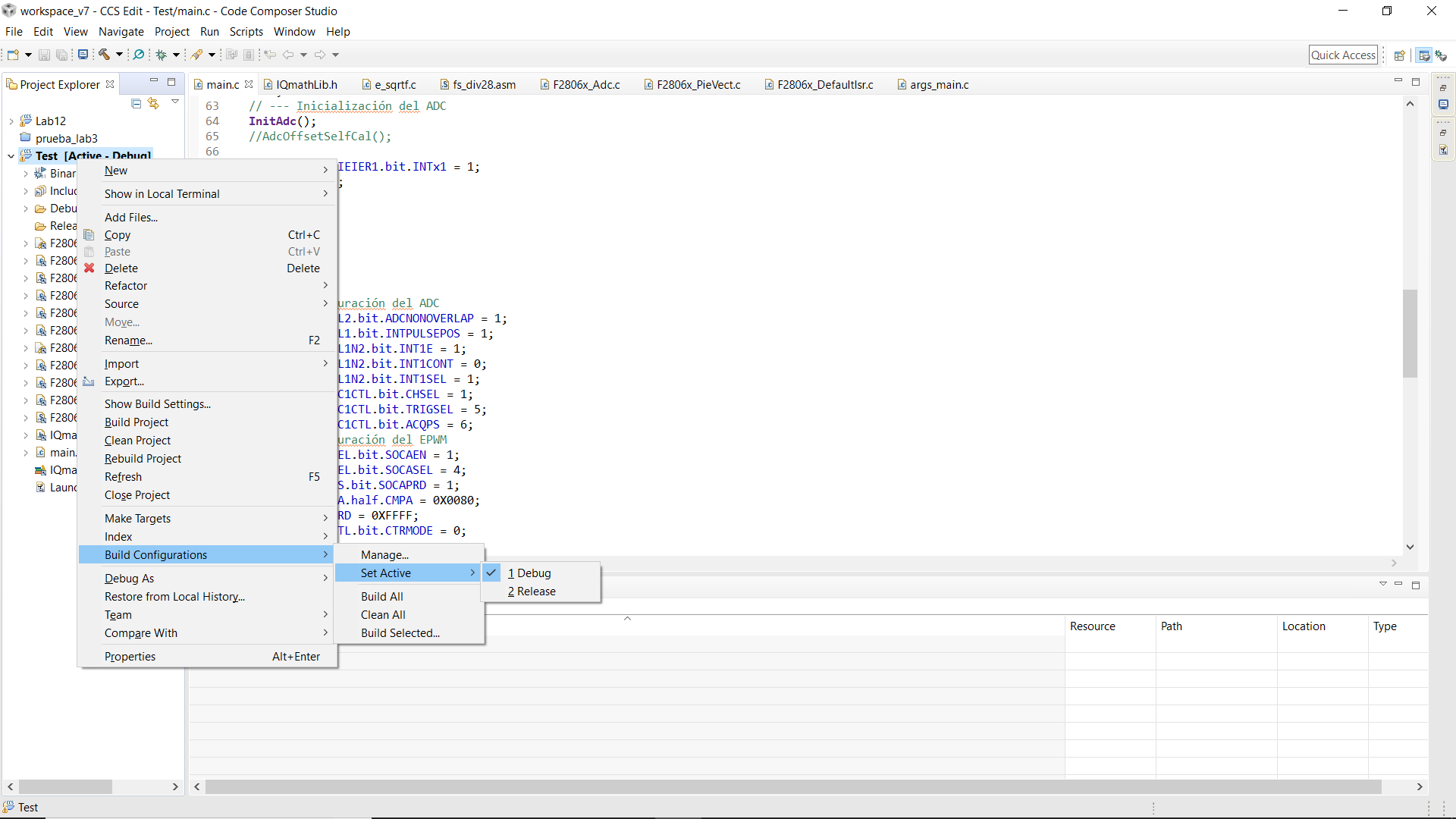

    InitFlash() needs few routines to be executed from RAM. The RAM routines have to be copied from Flash. This is done as part of ' memcpy(&RamfuncsRunStart, &RamfuncsLoadStart, (size_t)&RamfuncsLoadSize);'. As this part of the code is not executed in your code there is an issue in your code. Please define _FLASH in the CCS project properties -> 'Predefined Symbols'.
    To program onto flash please use 'CPU1_FLASH' build configuration. It takes care of adding the define '_FLASH'.
    You can change the configuration from Right Click on the project in CCS window -> Build Configurations -> Set Active -> Select 'CPU1_FLASH'.
    Please let us know if there is an issue.
    Katta
  • Thanks Katta
    I tried to do what you said, The definition "_FLASH" was ok, but the second step you said I couldn't do it. Look at the photo, you will see that "CPU1_FLASH" It's not an option.  Just there are two  -> DEBUG, ->RELEASE.
    Any Suggestions ?
    Mike
  • Hi Mike,
    Ok. It looks like you have created own project from blink led project.
    Then adding just the definition should be fine. Are you using a FLASH linker command file? It will be present in the same location as the F28004x RAM linker command file.
    Please let me know.
    Katta
  • Hi Katta
    The project I did it myself based on the lectures I've done about registers. I put the F28069M.cmd linker and I have discovered something. I moved the EALLOW instruction under of Initflash(); And It worked, Also I've noticed this not will work until I change the ADCSOC0 to ADCSOC1. How to get the program in Flash? Why did not work the program with ADCSOC0 ?
    Mike
