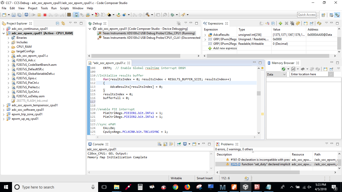

Part Number: TMS320F28377S
Please check the code. EPWM2 at GPIO2 is not generated as also shown in CMPA and TPBRD register also.

//Map ISR functions
    EALLOW;
    PieVectTable.ADCA1_INT = &adca1_isr; //function for ADCA interrupt 1
    PieVectTable.EPWM2_TZ_INT = &epwm2_tzint_isr;
    EDIS;
        EALLOW;
        CpuSysRegs.PCLKCR0.bit.TBCLKSYNC =0;
        EDIS;
        InitEPwm2Example();
        EALLOW;
        CpuSysRegs.PCLKCR0.bit.TBCLKSYNC =1;
        EDIS;

interrupt void adca1_isr(void)
    AdcaResults[resultsIndex++] = AdcaResultRegs.ADCRESULT0;
    if(RESULTS_BUFFER_SIZE <= resultsIndex)
        resultsIndex = 0;
        bufferFull = 1;
    Volt=AdcaResultRegs.ADCRESULT0;
    set_duty(Volt);
    AdcaRegs.ADCINTFLGCLR.bit.ADCINT1 = 1; //clear INT1 flag
    PieCtrlRegs.PIEACK.all = PIEACK_GROUP1;
void set_duty(int a)
    EPwm2Regs.CMPA.bit.CMPA = a;
void InitEPwm2Example()
    // Enable TZ1 as one cycle-by-cycle trip sources
    EALLOW;
    EPwm2Regs.TZSEL.bit.CBC1 = 1;
    // What do we want the TZ1 to do?
    EPwm2Regs.TZCTL.bit.TZA = TZ_FORCE_HI;
    // Enable TZ interrupt
    EPwm2Regs.TZEINT.bit.CBC = 1;
    EDIS;
    EPwm2Regs.TBPRD = 6000;                       // Set timer period
    EPwm2Regs.TBPHS.bit.TBPHS = 0x0000;           // Phase is 0
    EPwm2Regs.TBCTR = 0x0000;                     // Clear counter
    // Setup TBCLK
    EPwm2Regs.TBCTL.bit.CTRMODE = TB_COUNT_UPDOWN; // Count up
    EPwm2Regs.TBCTL.bit.PHSEN = TB_DISABLE;        // Disable phase loading
    EPwm2Regs.TBCTL.bit.HSPCLKDIV = TB_DIV4;       // Clock ratio to SYSCLKOUT
    EPwm2Regs.TBCTL.bit.CLKDIV = TB_DIV4;          // Slow just to observe on the scope
    // Setup compare
  //  EPwm2Regs.CMPA.bit.CMPA = 3000;
    // Set actions
    EPwm2Regs.AQCTLA.bit.CAU = AQ_SET;             // Set PWM2A on CAU
    EPwm2Regs.AQCTLA.bit.CAD = AQ_CLEAR;           // Clear PWM2A on CAD
