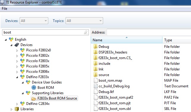

  • Vincent,
    there are two sources for that.
    C2000 controlSUITE , see
    and the successor C2000Ware.
    Here check installation under c:\TI\c2000\C2000Ware_1_00_04_00\device_support\f2833x\examples\f28335_flash_kernel\
     - SCI_Boot.c
     - Share_Boot.c
    Regards, Bernd
