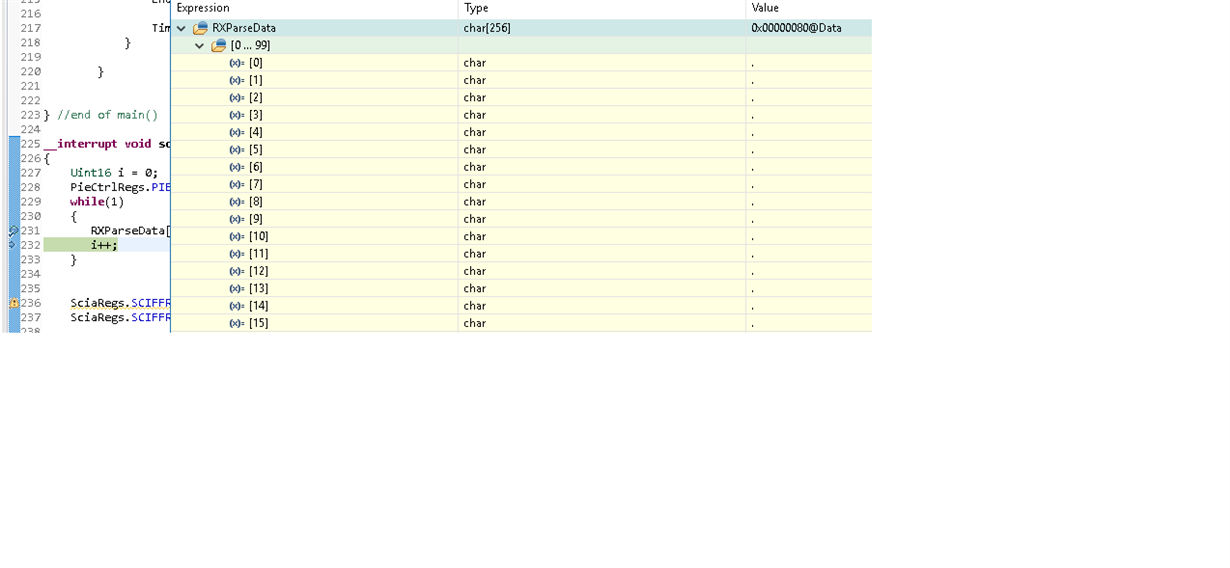

Hello! I'm trying to receive a string from an HC06 running at 9600BAUD. I have the same system working on the MSP430F5529.
This is the code that I imagine should be working. My problem is not actually receiving anything in RXBUF. I am getting interrupted which means I am receiving a byte, but nothing is being transferred to my array.
I've tried assuming LSPCLK is at 90MHz, and the default SYSCLK/4, which equates to 22.5MHz. Using the formula:
LSPCLK/(9600*8) - 1, I've found a value of 0x123 FOR 22.5MHz and a value of 0x492 for 90MHz to be stored in:
SciaRegs.SCIHBAUD = 0x0000;
SciaRegs.SCILBAUD = 0x0492; // 9600 BAUD, ive also tried 0x0123.
I must be doing something wrong! If someone could help me, that'd be greatly appreciated as this a small part for a school project!

  • Andrew,
    It looks like your Baud calculation is ok. If I understand you correctly, the interrupt is being generated (i.e. receiving data), but the issue is in the ISR where the array is not being loaded. In the ISR, please move the PIEACK to the top (just after Uint16 i=0). Please let me know if this solves the problem.
    - Ken
  • Unfortunately, this did not resolve the issue. And yes, you are understanding the problem correctly!
    ISR change:
    __interrupt void sciaRxFifoIsr(void)
       Uint16 i = 0;
       PieCtrlRegs.PIEACK.all|=0x100;       // Issue PIE ack
       while(1)
          RXParseData[i]=SciaRegs.SCIRXBUF.all;  // Read data
          i++;
       SciaRegs.SCIFFRX.bit.RXFFOVRCLR=1;   // Clear Overflow flag
       SciaRegs.SCIFFRX.bit.RXFFINTCLR=1;   // Clear Interrupt flag
    After some thought, I'm questioning my hardware set up. Right now, I have the TX of the HC06 connected to PIN 3 of the C2000. I have both jumpers on JP6 & JP7.  Could this be a problem?
    I have a fairly good understanding of UART, so i'd just like to ask: if I'm receiving an interrupt but nothing is being transferred to my array, how could I be receiving the interrupt? Wouldn't this be at least seen as a start bit, followed by eight 0's and then a stop bit? Would the array show 0's or simply just '.' as shown here (i = 9 @ the time of this screencap, after I sent the message 'Route 1'):

  • Andrew,
    I have noticed that you have an infinite loop in your ISR, which means that you will be stuck in this loop forever. At the same time, you do not have a while loop in main. The idea is that the code should be in the while loop in main (after initialization) until the interrupt is received and then ISR is executed where the data is copied to the buffer. After the copy is completed, the code returns to the while loop in main and the process repeats. Also, it is not clear if you are disabling the watchdog. You should disable the watchdog while testing your code. To confirm the watchdog is disabled, place a breakpoint after the first line in main and you should not get halted there. If the watchdog is enabled and not serviced you will be constantly resetting the device.
    For an example of how to service the SCI, please see the following in C2000Ware (download the latest version):
    C:\ti\c2000\C2000Ware_1_00_04_00\device_support\f2806x\examples\c28\scia_loopback_interrupts
    Notice the ISR at line 236. Also, notice the loop in main after initialization at line 98.

  • Andrew,
    1. Verify LSPCLK's frequency.
      1. Your first post you said you've assumed your LSPCLK... I would recommend using XCLKOUT to verify the frequency, baud rate mismatches are a common problem.
    2. Can you use an oscilloscope to confirm that the HC06 is sending data, and that the data is coming in at the correct baud rate?
      1. It probably is, but please humor me
    3. Have you connected TX to RX and RX to TX?
      1. You would be surprised how often this happens.
    Now, the way you have written this while(1) loop in your ISR will cause your buffer to flood with 'data'. The array will fill indiscriminately of if you have data in the RXBUF.  Because you have received an interrupt I would have expected that the first few array elements should have had values.(that is weird)Now I have never read from the RX buffer as fast as the device would let me before, so I honestly don't know what 'data' it would fill the buffer with assuming there were no values in the RXBUF. Occasionally yes you would receive a value in the buffer and that would be transferred to the array, but it would be overwritten at some point.
    I recommend that you read from the RXFFST registers and then decide how many words you would like to pull out of the FIFO. As you read the words you can put them into an array if you would like, but after that you should acknowledge the interrupt and return from the ISR.
    Forgive me if I missed any of this information in the posts above.
    Cody

  • Andrew,
    Sorry Andrew, I can't provide code without a significant amount of legalities. Configuring XCLKOUT is very easy though...select XCLKOUT on GPIO18's MUX configuration, then ensure you are using the correct dividers( see figure 1.4.2.11 "XCLKOUT Generation" in the TRM) and check that you see the clock rate you expect on GPIO18.
    If you didn't want to use the FIFOs why do you have them configured(see quote below)? You should use the FIFO, the code you started from already configures them so it shouldn't be any extra work.
    Andrew Wenaus said:
    SciaRegs.SCIFFRX.all=0x0022;
    I would also recommend that you create a standard communication language, there is no need to make it human readable "ROUTE 1" and "GO" could be coded into a shorter message like "R1" and "C1" where the number following an R is a route selection and the number following a C is a command (0= stop, 1= go,2= idle,3= victory dance, etc.) It will speed things up!
    Yes, having a jumper on JP6 and JP7 is likely an issue, the schematic states that this is "UART Disable". If you want to use UART on GPIO28 and GPIO29 then you should configure MUX_SEL=0 and CH_SEL=1. The selection of MUX_SEL and CH_SEL is done with JP6/JP7 and is fully described on Page 6 of the schematic. The schematic(LAUNCHXL-F28069M_sch.pdf) can be found in both C2000Ware and controlSuite.

  • I just confirmed system clock is 90MHz! And regarding the standard communication idea, that is a fantastic idea! Thanks for that!
    I fixed the JP6 and JP7 situation, but now I dont get an interrupt at all!
