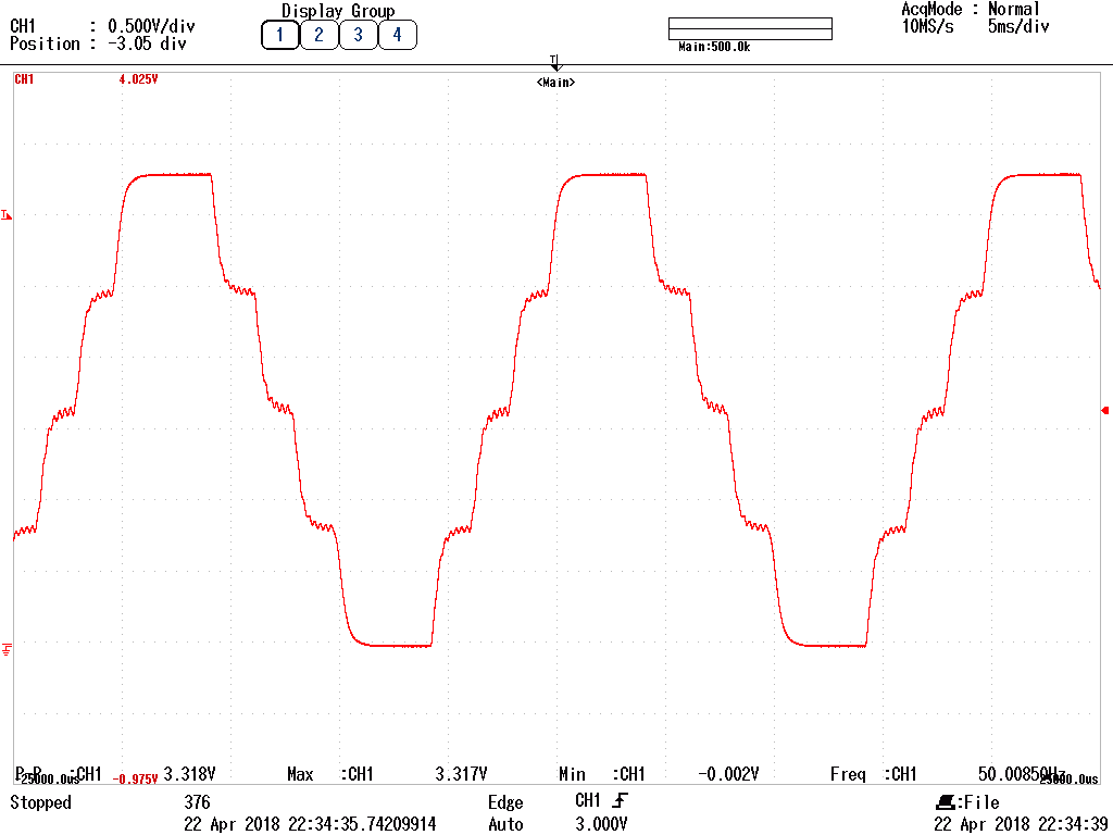

I want to generate stepped sinusoidal waveform in which the number of steps will determines the number of switches to be turned on. I will generate sinusoidal reference using harmonic oscillator and based on the number of steps (N), it should able to generate stepped sinusoidal wave form that many levels (N) . Can I use timer interrupt to sample the sinusoidal to get the mentioned waveform to calculate no of switches to be turned on?.  How to generate and use the stepped sinusoidal to determine number switches to be turned on?.
Below I showed with positive shifted sinusoidal input reference for generating 2,4,8 stepped wave forms. It can be done by multiplying unit sinusoidal with levels and rounding. (V*/Vdc = No of levels(N)).

  • Dear Cody,
    I want to calculate number of switches to be turned on from that reference generated based on N (Number of levels). Once I got number of switches to be turned on, I have to perform sorting based on that in DSP.
    How many switches to be turned on will get from reference sampled sine waveform that will be given as input to sorting to assign which switches to be turned on.
    So I no need to generate waveform but somehow I have to calculate number of switches to be turned on, that depends on sampled sine wave with given N. I am not giving that to any switch directly before that i have to perform sorting operation.
    Can you please tell me how to get that number to perform sorting in dsp before giving to switch drivers?

  • Dear Cody,
    I will try and let you know.
  • Dear Cody,
    Generated that reference using round function and same validated or to see, used epwm + low pass filter as dac to see generated waveform. I hope based on the reference values got from round function, can set how many switches to be turned on I think.
