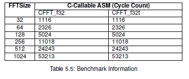

2. I found the example project 2837x_cfft in C2000Ware.
How much time is consumed by different points of ICFFT/CFFT operation? Such as 128, 256, 512, 1024, 2048 points.

    The execution benchmarks for the cfft_32t function can be found in Table 5 on p.28 of the user's guide for the FPU32 DSP software lib. If you have installed the latest C2000Ware in the default location, you can find the document at:
    C:\ti\c2000\C2000Ware_1_00_04_00\docs
    The inverse operation benchmarks are on p.45 of the same document.
