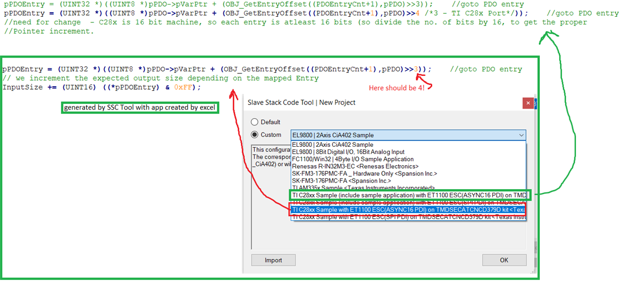

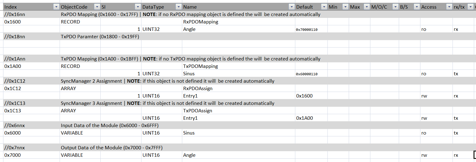

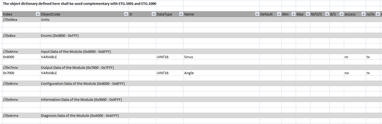

I successfully fired sample application for TIDM-DELFINO-ETHERCAT. Now I would like to change process data for my project. I prepared stack code using SSC and I created new application in Excel:
Next, I put ESI XML file in EtherCAT directory.
I prepared mapping too. Here is the code:

In CCS I can see that my variables were mapped:

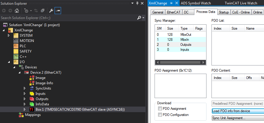

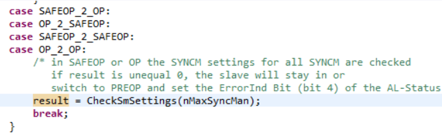

But when I fire TwinCAT I can see error which means that SM configuration for input process data is invalid:
I have no idea what I am doing wrong. It's my second day when I am fighting with this and my ideas are done.
Do you know where I am doing a mistake?
I appreciate any help.
