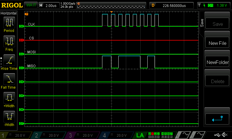

The data I am sending is: 0x20 0x48 0xAA 0x00 0x00 pretty basic. I can see the RX interrupt being thrown and data being available.
I've confirmed signals on the SPI lines with my scope. Pretty straight forward too.
The issue I am having with the Slave is that it sends data out on the MISO line even though I physically do not have any code that writes any data to the TX buffer.

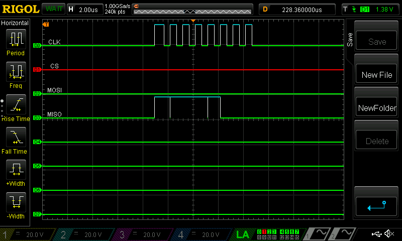

What is even stranger, data comes out on the MISO pin and corrupts the data on the MOSI. Almost every second transmission, the 3rd byte is processed as 0xB5 and not as 0xAA. Please see images below.
This first image shows data 0x20 0x48 0xAA 0x00 0x00  being transmitted to the Slave. iYou will notice that the Slave is responding with data on the MISO even though I've not told it to send anything. In this example the Delfino correctly receives the 3rd byte as 0xAA.
In this example below, the Master is sending identical data again, however this time the slave very briefly pulls the MISO line high. In this example the Slave thinks the 3rd byte is 0x5B.
Any advice would be much appreciated.
  • Dainius,
    Data coming out of MISO pin isn't a strange behavior. That is how SPI hardware is implemented because SPIDAT is essentially a shift register.
    Clearing TALK bit (SPICTL.TALK = 0) will put MISO pin in high impedance state and the data will not echo back.
    Manoj

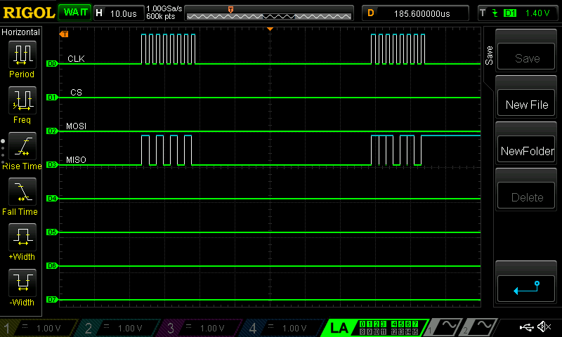

  • Hi Manoj,
    So I have re-wrote the way I was processing the received bytes. Now the RX IRQ is thrown every word (8 bits) and I receive all data as expected. Received data is not getting corrupted. I have to keep writing zeros to avoid data corruption, but anyway it does seem to work.
    In addition, I have progressed with implementing responses from the Slave, majority works well, however the Slave (F28379D) seems to sometimes (75% of the time) fail to clock the MISO bits correctly. The Slave is suppose to send value 0xBA. Sometimes is sends it fine, sometimes it misses the CLK.
    Below is example of what a correct response is. Slave responds with 0xBA.
    If I send requests one after another to send back 0xBA, sometimes the returned data is messed up. The slave return 0xF8 instead of 0xBA.
    The Bitrate is set to 1MHz, and the Master is in SPI mode 1, and Slave is in mode 0.

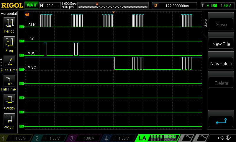

  • Manoj,
    In addition to my most recent reply, I would like to give you more information. I have implemented the TALK flag toggling throughout the transmission. As before, I am trying to use the SPI bus to receive data from the Slave. At the moment the Slave is suppose to reply 2 bytes of data 0xAA 0xAA.
    The image below, shows the MISO signal being HIGH until, the TALK flag is set by my software. The Slave sends 2 bytes and the software sets the MISO back to HIGH.
    I am feeling much happier now that I understand a bit more about the TALK bit. However, I had to make some strange function calls to make this work. Please see below:
    else if(READ_TWO_BYTES == request_internal.code)
        uint16_t upper = (read & 0xFF00);
        uint16_t lower = (read & 0x00FF);
        SPI_resetRxFIFO(DEVICE_SPI_BASE);                         //<--- Had to add this to stop sending data that was just received
        SPI_resetTxFIFO(DEVICE_SPI_BASE);                         //<--- Had to add this to stop sending data that was just received
        spi_enable_slave_output(DEVICE_SPI_BASE);                 //<--- This is my custom function to set TALK = 1
        SPI_writeDataBlockingFIFO(DEVICE_SPI_BASE, upper);
        SPI_writeDataBlockingFIFO(DEVICE_SPI_BASE, (lower << 8));
    Everything seems to be pretty good in this configuration other than the fact that the signals on the MISO line are corrupt. Here is a closer view.
    Here is a good 0xAA.
    Here is the last byte of the transmission. Should be 0xAA, but it gets processed as 0xED.
    I should point out that most of the time, both bytes get corrupted, not just the last one. I've confirmed via the CSS debugger that the code is actually sending 0xAA for both bytes.
    I really appreciate your support.
