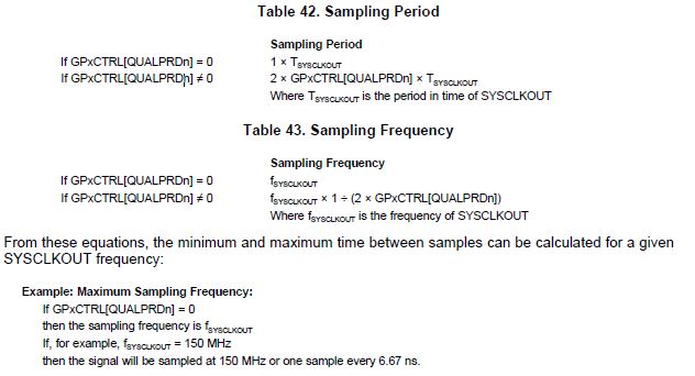

I am using TMS320F28335 and I need some clarification about qualification period settings.
I set the qualification period to 0xFF as follows.
GpioCtrlRegs.GPACTRL.bit.QUALPRD3 = 0xFF; //set sampling period
Question
I understand that QUALPRD3 settings affects  GPIO24-GPIO31, if I set the qualification window to 0 for GPIO24 as
GpioCtrlRegs.GPAQSEL2.bit.GPIO24 = 0;
Will GPIO24 affected by 0xFF settings of QUALPRD or will it use ONE SINGLE cycle of SYSCLOCKOUT?

  • Hi Zaw,
    You can refer the below computations:
    You can find the above data in SysCtrl and Interrupts User guide SPRUFB0D.

    Thanks for the reply. I asked a wrong question. Here is what I actually wanted to ask.
    I want ONLY GPIO26 to be affected by QUALPRD. However, according to the document, if I set QUALPRD3 a value, this value affects NOT ONLY GPIO26 BUT ALSO other gpios GPIO24-GPIO31.
    If I only want GPIO26 to have only this QUALPRD value, how should I do it?
    Setting like the followings make all other GPIOs not taking the value of QUALPRD?
    GpioCtrlRegs.GPAQSEL2.bit.GPIO24 = 0; // setting zero for qual window will not take QUAL PRD value?
    GpioCtrlRegs.GPAQSEL2.bit.GPIO25 = 0; // setting zero for qual window will not take QUAL PRD value?
    GpioCtrlRegs.GPAQSEL2.bit.GPIO26 = 2; // This will definitely MAKE USE of QUAL PRD value with 6 samples!!
    GpioCtrlRegs.GPAQSEL2.bit.GPIO27 = 0; // setting zero for qual window will not take QUAL PRD value?
    GpioCtrlRegs.GPAQSEL2.bit.GPIO28 = 0; // setting zero for qual window will not take QUAL PRD value?
    GpioCtrlRegs.GPAQSEL2.bit.GPIO29 = 0; // setting zero for qual window will not take QUAL PRD value?
    GpioCtrlRegs.GPAQSEL2.bit.GPIO30 = 0; // setting zero for qual window will not take QUAL PRD value?
    GpioCtrlRegs.GPAQSEL2.bit.GPIO31 = 0; // setting zero for qual window will not take QUAL PRD value?
    Zaw Htoo
  • Hi Zaw,
    Your understanding is correct.
    QUALPRD sets the qualification time between samples for a group of GPIOs.
    QSEL determines whether a specific GPIO uses qualification & if so, how many samples to use.
    Thank you,
    Brett
