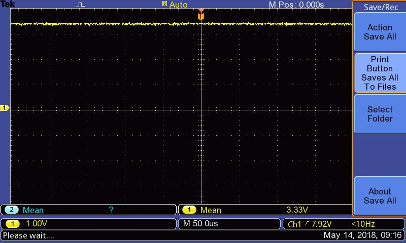

  • If you run the ControlSuite example "as is" does the CCE bit get set? Can you scope the CANRX pin to see its logic level?
  • Both the CANRX and CANTX pins are high before trying to init the eCanA. It will take me some time to try the controlSuite because I haven't setup the environment before. I'll report once I've tested it. Please share If you have some thoughts according to the pins logic level.
  • If the CANRX pin is sensed high (bus idle condition), the CCE bit should get set. Can you post the circuit connected to the CAN pins and the scope shots showing the pin levels?
  • The circuit connection is the same as on the LAUNCHXL-F28069M. I also plugged the launchpad and experiment with it right now. I attach the oscilloscope shot from the CANRX pin.
