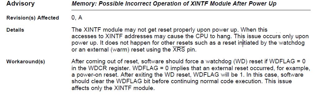

  • Akhil,
    There is an errata for XINTF.
    Please make sure you have implemented this in your application.
    Vivek Singh

  • I tried that, but this workaround is not working. instead of xintf, If i use Gpio pins, there is no problem. Could you suggest any alternative solution?
  • Akhil,
    Can you elaborate on your emulator error message?  Is it a permanent fail state or can you reconnect?
    I see that you are trying to access Zone 6 addresses, but your code only configures the Zone 7 timing registers.  Your initialization code also appears to configure the WR timings twice with different values:

  • Akhil,
    It looks like you are enabling the Watchdog but I don't see it being serviced. That could explain your device behavior if it is throwing timeout resets.
    -Tommy
    I read about a workaround with xintf, and it says it should be reset once after power on reset. So, I want it to reset once and then the the WDFLAG would be set saying that it is a software reset and then it shouldn't be happening forever.
  • Akhil,
    I would suggest to scope the XRSn pin and make sure the workaround is working as expected. Let us know what do you find.
    Vivek Singh
  • Akhil,
    Yes, you will want to generate a watchdog reset once. However, the WDFLAG alone will not stop the watchdog from running. After the watchdog reset completes, your code should clear the flag and then either disable the watchdog or service it periodically.
    -Tommy
    Okay, I'll try that and will post if it worked or not!
    Akhil
  • Akhil,
    It has been over two weeks since your last update. I assume that you were able to resolve your issue. If this isn’t the case, please reject this resolution and reply to this thread. If this thread is locked, please make a new thread describing the current status of your issue.
    -Tommy
