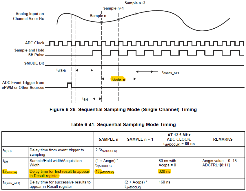

Part Number: TMS320F2808
What is the practical analog to digital conversion delay in TMS320F2808 development box. How to quantify the error in measurement due to this delay
