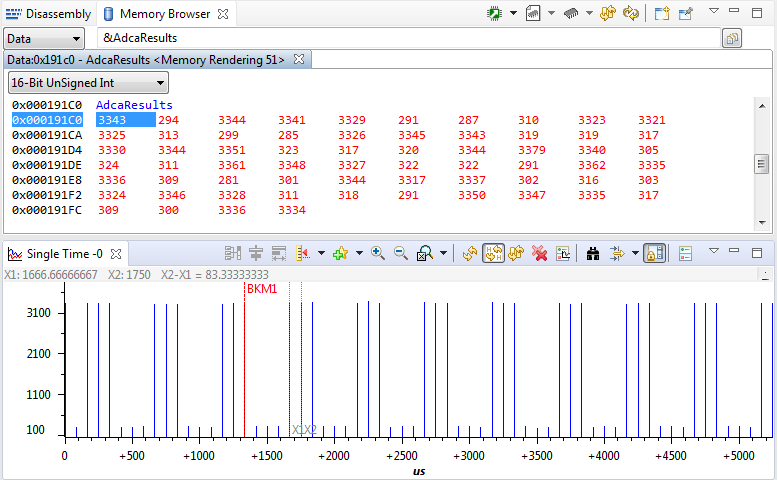

The first picture with sampling period 83.33 microsecond which what I got when I run the project and sampled my 2 kHz square wave input.

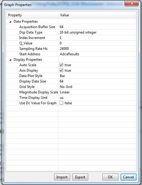

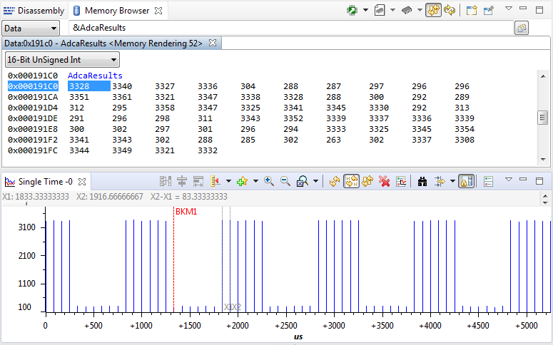

This picture when the sampling period is set to 41.665 microsecond, but when I run the program it shows the sampling period is 83.33 microsecond. If you look at the plotted adcresults, looks my 2 KHz input becomes 1 kHz. Honestly, I tried to solve it but I coudn't. One of the thing I tried is by changing the cpu clock from 200 MHz to 100 MHz in the cpu configuration register, but it didn't work .
For your information: I didn't change the system clock setting. hence I guess the pllsysclk is either 200 MHz or 100 MHz. I got IMULL = 20, FMULL= 0.0, SYSDIVSEL = 1 as in the picture below:
