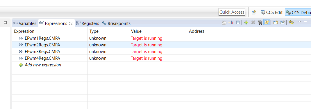

I have found a simple workaround. Firstly I set the switches to  TRST=1, GPIO84=0. GPIO72=0 and press reset button before launching debugger. In this situation debugger seems to be working. I can set breakpoints etc. but the expression screen does not work. The Continuous refresh does not works and I see value "Target is running".
In the other projects i set switches to TRST=1, GPIO84=1, GPIO72=1.
What could be a reason of such strange behavior?
