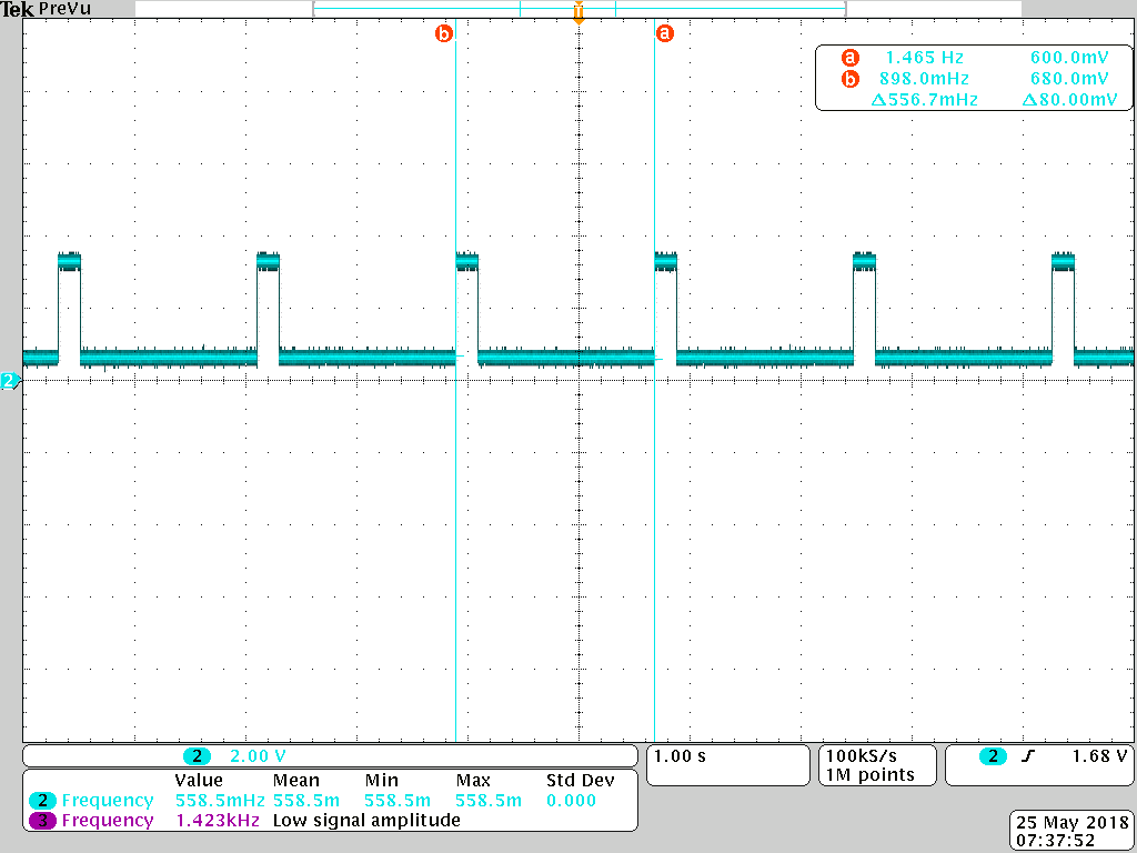

I've recently put together a PCB and i'm trying to program it through the SCI Bootloader by a Program called C2Prog
Whenever I run the program I get the following error:
*** PLEASE RESET TARGET IN SCI BOOT-LOADER MODE ***
Pinging target... Baudrate locked.
Bootloading... echo error!
Does any one know a possible cause of this?

Try following this sequence:
1) Configure GPIO for SCI bootmode
2) Power-cycle / reset MCU
3) Click "Program" in C2Prog GUI
@Vamsi I've contacted the C2Prog fellows and they're also working with me (trying to get as much info as possible)
I've made sure to measure the following criterias are met:
TRST = 0
GPIO37 = 0
GPIO34 = 1
are all set as the micro-is powered on (already tied to either VDD, or GND)
However, whenever I look at the TX line is constantly toggling and it's sitting at a slightly higher voltage level than ground
I've attached a picture of the capture. I'm not sure if this is typical behavior or not in SCI bootloader mode
