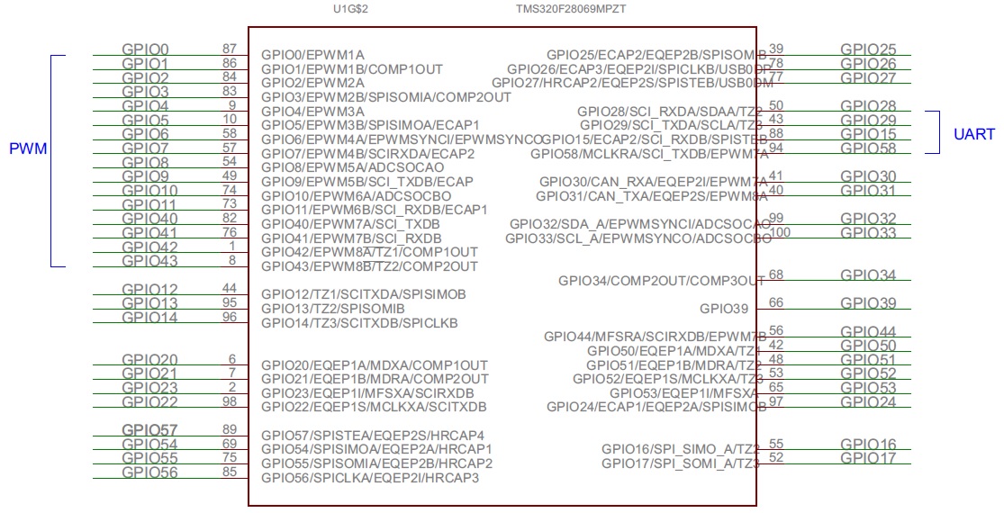

Hello all,
I use Launchxl-F28069m kit.
I read and write values from/to my pc with sci communication. There is a "WRITE EEPROM" button on my pc interface and when I press that, I deactivate sci, activate i2c parts to write to eeprom.
After writing to eeprom, vice versa. I deactivate i2c and reactivate sci.
But, this is not working. As I understand, SciaRegs.SCIFFRX.bit.RXFFST and I2caRegs.I2CFFRX.all are the problem.
For sci, I used a little different version of sci_echoback, for i2c, more or less i2c_eeprom example.
If I configure switching sci - i2c event with a gpio, for example GpioDataRegs.GPADAT.bit.GPIO18, the plan works perfect. But I dont want to use a hardware switch. (Talking about If GpioDataRegs.GPADAT.bit.GPIO18 == 0 go for i2c,  if GpioDataRegs.GPADAT.bit.GPIO18 == 1 go for sci stuff.)
Normally SciaRegs.SCIFFRX.bit.RXFFST is 0. If it is 0, everything works smoothly. When I switch with WRITE EEPROM software signal from sci, SciaRegs.SCIFFRX.bit.RXFFST becomes 3. (Receive FIFO has 3 words.) Or 4.
My i2c and sci configurations are shown below :

I2caRegs.I2CMDR.all is also suspicious.
This can be a bit detailed question so feel free to ask me any details to clarify. There should be a simple detail because with GPIO it works. (NPN. I touch GPIO with a cable connected to gnd.)
I should change my communication method with soft signals. FIFO should let me.
P.S: I tried adding delay, it does not solve the problem.
P.S 2: Using WriteEprom causes the problem. Not ReadEeprom.

  • Hello Mark,
    Thanks for your answer.
    I have designed a C# interface communicating with launchxl via sci. Pc is connected to kit's mini usb. Sci is done from here.
    EEPROM is connected to GPIO32 anf GPIO33 with the circuit below.
    And this is the controller
    Briefly, I will use my interface to control my system. When I am online, I read values from ram, write to ram etc. But ram is volatile so there is a "Write To Eeprom" button that makes my parameters retentive.
    When I press that button, with my sci interpreter protocol f28069m understands that as "writeToEepromButton".  So if I am able to use software buttons, I thought I don't need to use hardware switches etc. I am not pin limited, actually I have many unused pins but I didn't know it is not recommended. The plan is below:

    SCI is being done from "mini usb" and i2c is from GPIO32 and GPIO33. Are they using the same UART line? Sorry for lack of my hardware knowledge.
    So I definitely should incorporate a switch to physically swap what the GPIOs are connected to?
  • I misunderstood your original intent. I had thought you were using I2C and SCI on the SAME pins. This was my mistake. For the issue at hand, you can ignore my entire original post :) SCI is using GPIO28 and GPIO29, or GPIO15 and GPIO58 depending on JP7 and JP6 configurations. SCI is then routed through the XDS110 v2 debug probe to the PC through USB. I2C is using GPIO32 and GPIO33. You mention a lack of hardware knowledge but have the full Schematic and your code to verify with. This is really step 1 of working with HW in embedded systems.
    Really, this appears to be a program flow issue.
    This is telling me that the UART is receiving some characters while you are off doing I2C activity. I recommend observing on the scope during your different program phases to ensure that no stray messages are being transferred. What data is in the SCI FIFO? is it a message that you might expect the PC to send? can you prevent the PC application from transmitting additional data after clicking the "eeprom write" command?
    This device is fully capable of doing what you are trying to accomplish, and I have done something similar myself. It sounds like you are not quite sure all of the messages that are being sent around. grab your scope and start observing every interaction!
    -Mark
  • When I check with scope, I saw an unwanted character that makes SciaRegs.SCIFFRX.bit.RXFFST 4. Then I realized a mistake at my sci protocol algorithm.
    Now everything is working smoothly. It is awesome that Launchxl-f28069m is capable of changing communication type via software, without any hardware switch. Now I have several plans about this.
