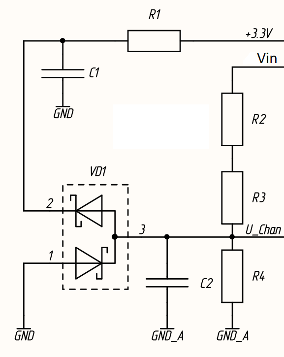

    Here is a piece of the circuit, associated with the adc. Vin - voltage input, and U_Chan - line going directly to the adc input pin:

  • Igor,
    I understand. Let's walk through it. The ADC on F280049 supports both internal and external references. For Internal reference mode, the reference voltage is supplied internally. This internal voltage is however still brought out on the VREFHI pin for filtering. This is why even in internal reference mode, you still have to place caps on the VREFHI pin. You can verify this by putting the device in internal reference mode (AnalogSubsysRegs.ANAREFCTL.bit.ANAREFASEL=0) and measuring the voltage on the VREFHI pin. This voltage will be 2.5v or 1.65v depending on the bit value of (AnalogSubsysRegs.ANAREFCTL.bit.ANAREFA2P5SEL). In the figure below, you can see in the highlighted portion where the internal reference brings the voltage out onto the VREFHI pin.
    Furthermore for 64-pin package, the 3 ADC references VREFHIA, VREFHIB and VREFHIC are ganged together into one VREFHI pin. If you switch to internal reference mode on the 64-pin package, all 3 internal reference voltage will try to come out on this single pin and as you probably realize, there will be contention. To prevent this contention, 2 of the internal references have to be disabled using the ANAREFPP register. For 64-pin TMX devices, this has to be done by the user. However for TMS devices, this is handled automatically in the bootrom at boot. Also, it is recommended that all 3 ADC references be configured the same way. So even though in the 64-pin package VREFHIB and VREFHIC internal references are disabled, they should still be configured the same as VREFHIA.
    I hope this clears up the references for you. For the issue you are facing, with one board working and one not, you are most likely having a board issue. As i mentioned, you can debug if internal reference is working by switching to internal reference mode and measuring the voltage on VREFHI.
  • Thanks for the exhaustive explanation, now everything works.
    All i need is just to configure all 3 references the same way. Even if i don't use this adc.
  • Glad i could help and yes, that's right. All 3 ADC references should be configured the same way.
