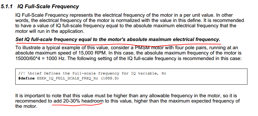

Dear Champs,
I have some confusion about the IQ Full-Scale Frequency mentioned in InstaSpin foc&motion user guide.
The text highlighted with red bottom line shows that IQ Full-Scale Frequency equals to the motor's absolute maximum electrical frequency, but below text shows that it is recommended to add 20-30% headroom to this value, higher than the maximum expected frequency of the motor.
Can you please help me understand which one is correct? If both of them are correct, how to understand those 2 maximum frequency?
