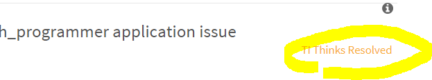

    Also this issue is not resolved, please remove the following:
    sal
  • Please see reply
