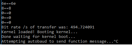

Hi guys.
I'm new to TI dev boards. Currently I am trying to flash a F28377S dev board using SCI.
Tried to follow this example implementation .
Short:
  1. imported blinky example into workspace + built it + processed  *.out file to *.txt using "hex2000.exe -boot -pdb -sci8 -a -o OUTfile.txt INfile.out"
  2. imported flash_programming into workspace+ built it + processed  *.out file to *.txt using "hex2000.exe -boot -pdb -sci8 -a -o OUTfile.txt INfile.out"
    1. as these are examples I suggested everything to be straight forward.
  3. prepared the board to boot to SCI (dipswitches)
  4. started the SCI flash using "serial_flash_programmer.exe -d f2837xS -k flash_programming.txt -a blinky.txt  -p COM4 -b 9600 -v
Sadly there seems to be something wrong. As you can see the Kernal seems to be loaded but does not autobaud any more.
Maybe there is someone out there with a good idea how to solve this.
Is there something to change in a .cmd or header file? Do I have to change some build options?
Thanks a lot.
Lukas
  • The flash_programming example is not the kernel. You need to use the sci_flash_kernel. This is why it is not achieving the second autobaud lock.

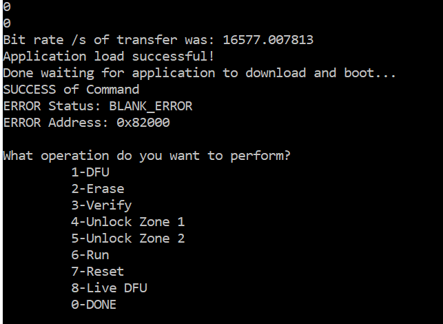

  • Hi.
    We are achieving out goal step by step.
    I found a new version of http://www.ti.com/tool/C2000Ware and used the provided serial_flash_programmer. Lucky me, i was successfull. After kernel showed his options I was able to select DFU without any error. There were bytes scrolling over my screen, so I was very happy.
    Sadly there is another error at the end of these bytes:
    Searching for "BLANK_ERROR" in the Serial Flash Programming Doku I found nothing but a short table.
    I am very thankful for all your support as I am stepping from error to error and most of the time can not find any solution.
    Thanks a lot
    Lukas
    Glad it is working much better.
    The BLANK_ERROR should only be sent when you using an ERASE command. I am not sure why this is being received if you are only doing a DFU.
    Have you tried doing a DFU and then a RUN to see if the flash application is working properly?
    sal
  • Hi Sal.
    Yes I have tried DFU and RUN the flash application. Sadly no success. So I tried to flash some code (blinky) to the board using CodeComposerStudio. As this code was linked and built for FLASH I assume it to even run after pressing the RESET button on board. Even this was not successfull as the LED does not blink any more after pressing RESET.
    I then did some debugging and luckily got my hand on another board. The steps mentioned above are working great on the other board. So I think there is a problem with my current board. Maybe a wrong startAdress?!
    So I think I did something very bad with my current board. Maybe changed the startAdress to some invalid state. But in my understanding, this is not permanent and will be changed if flashing another code using CodeComposerStudio.
    Tomorrow I maybe will have the chance to try the whole FLASH flashing process using another board. But I do not want to risk bricking another board without knowing what went wrong in the first place.
    Any suggestions?
    Is there a way to just reset the board to a initial state (factory reset) ?
    Lukas
