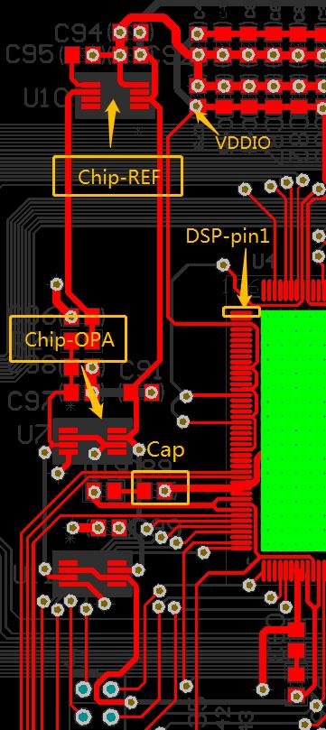

I try to make a circuit board using master chip TMS3220F28379D to realize A/D convertion. The A/D test I made using the same program. The result compared to LAUNCHXL-F28379D result is show below. It seems that it is quite a bit wrong except the Vpp.  What do I missed?

    The schematic diagram and PCB pictures of ADC module part is shown below.

  • Hi DITNY,
    Are these the decoupling capacitors for the VDDIO rail?
    These are to absorb high frequency transients from the power supply and as such need to be physically distributed to each supply pin and be close to the device.  This is probably not causing the issue you are observing, but this will certainly impact the noise and reliability of your design.
    The concern with the reference oscillating is that op-amps are not good at driving capacitive loads.  With a large capacitive load, the op-amp output can oscillate.  You'd wan to scope the VREFHI pin during ADC operation to look for noticeable ringing.  If you are using the launchpad design of OPA350 + 0.1ohm + 22uF we have simulated the circuit to ensure it is stable;  this should be OK as long as you don't add significant additional capacitance to the pin.
    You also might want capacitors on the ADC inputs.  About 220pF to 330pF, COF or NPO type.  Single-ended inputs have the capacitor between input and ground, differential inputs have the capacitor between the two pins (on the launchpad these caps would go on the boosterpack boards).
    Are you sure the input signal is making it to the input pins undistorted?

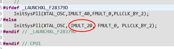

  • Hi DITYNY,
    If the ePWM clock is 100MHz, the ePWM is in up-count mode, and the period is 4096 counts then the sample rate should be about 24kHz. It looks like you are two orders of magnitude off of that (6kHz).
    Check the ePMW multiplier in the expressions window to see if it is 20 or 40...you may not have the flag defined that tells the code this is a launchpad?
    Check the other ePWM dividers. You should only need one /2 divider to get to 100MHz from 200MHz SYSCCLK.
    You may also want to verify the SYSCLK using XCLKOUT.
    You can also setup the ePWM to toggle a pin at the same time the trigger occurs so that you can experimentally verify the sample rate.
  • Hi,Devin Cottier.
    You are right. As you said, I think I did not  have the flag defined that tells the code this is a launchpad. Because I change the IMULT into 40 and it works in device support exmaple code of TI for Launchpad and self-made board,  which have about 12 points per period.
    But there raises another question. When change the IMULT into 40, the code ,which imitates device support exmaple code of TI , works in lauchpad but not in my board.  The results in my self-made board is similar to the result when I first proposed  this post.
    The chip I used is 28379DPTPS and in lauchpad is 28379DZWTT. Is that happens connected with chips different?
    And can you tell me how to have the flag defined that tells the code this is a launchpad?
    DITNY.
